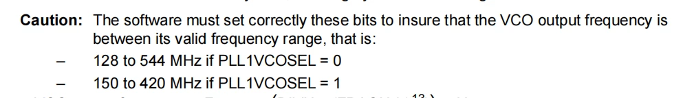

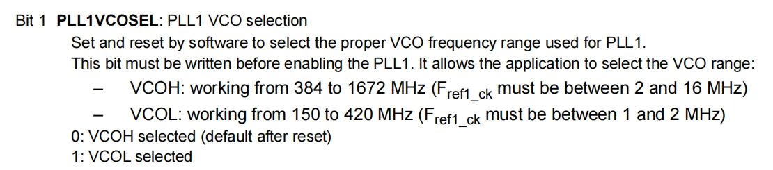

STM32H7R7: ambiguous PLL VCO range
The VCO range has 2 version in STM32H7R7 RM, so which is correct?

Dear @VSF ,

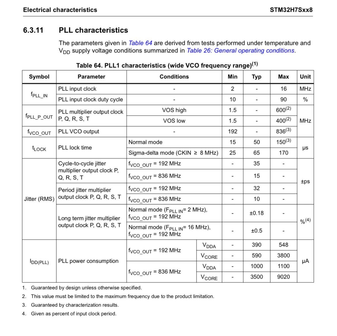

Thank you very much for posting the question , VCOL is correct but VCOH the right ranges are in product datasheet here :
https://www.st.com/resource/en/datasheet/stm32h7s3a8.pdf#page198
we should fix the Reference Manual and make a reference to the datasheet.
look at row : fVCO_OUT for Wide range table 64.

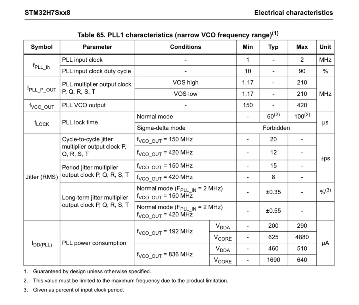

just saw another typo in Table65 in datasheet for IDD(PLL) last raw condition should be 150/420MHz not 192/836MHz . We should fix as well
