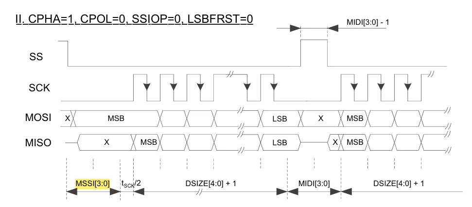

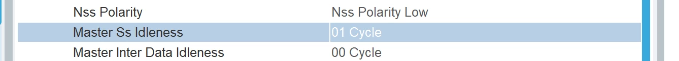

Increase the time between CS low and SCK pulse if the device requires this. Do this by setting MSSI to 1 or higher.
Do that here:
Juku80001Author
Sep 12, 2025 2:30 PM UTC
Thank you for your answer!
I should have mentioned this too at first, but I have already tried both the MSSI and MIDI (just in case) with various values, though none in the range of 0-2 make a difference in the result.
Sep 16, 2025 12:01 PM UTC
This works for me. Reference manual says it works. I don't know why it would be different for you.
