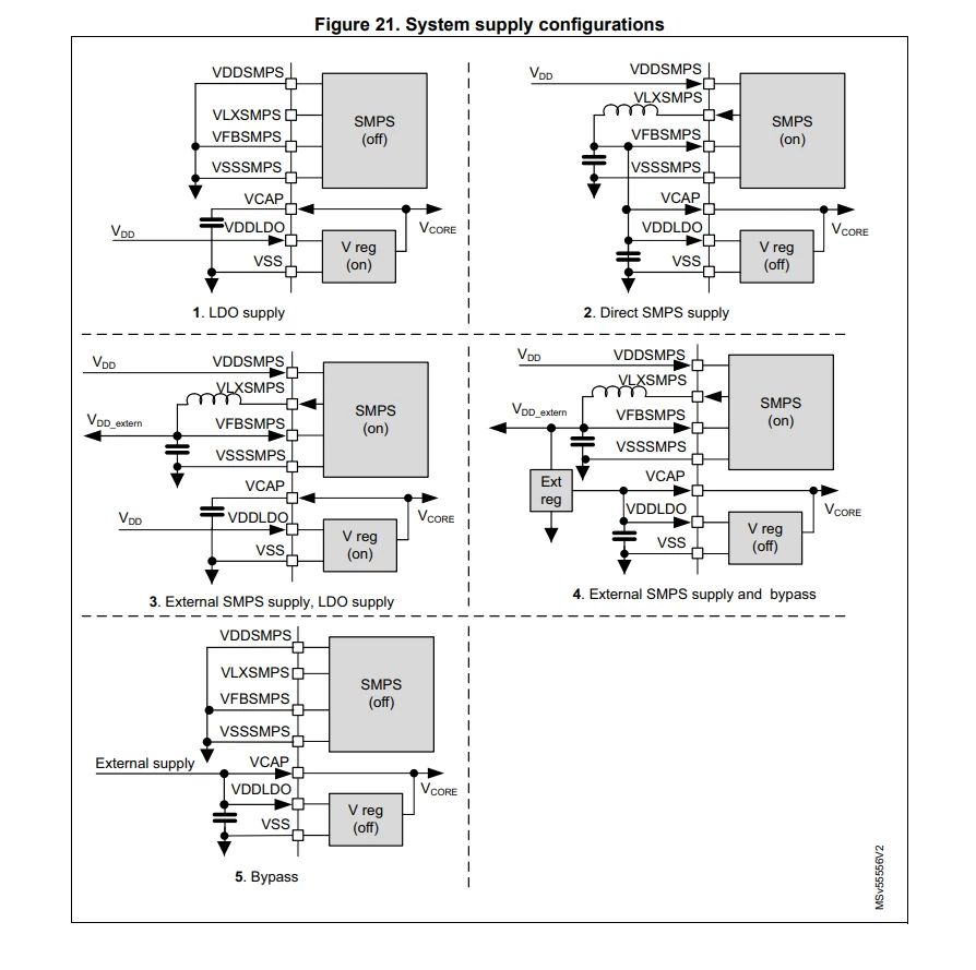

Can anybody explain how it is possible to power VCORE directly from SMPS output?

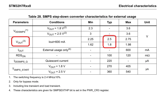

I see that SMPS have only two possible output voltages, 1.8V and 2.5V:

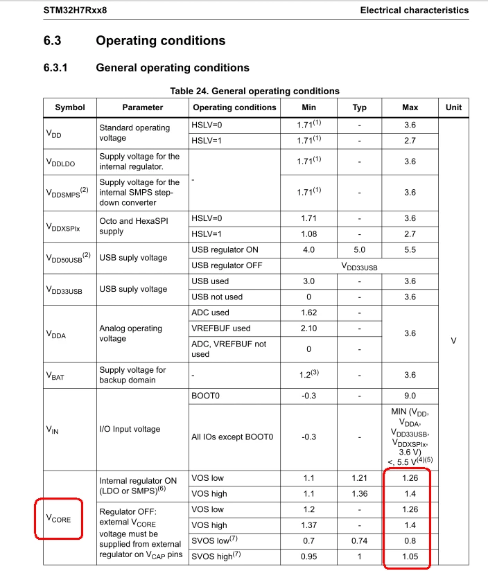

But VCORE accepts absolute maximum of 1.4V.
So how it is possible with LDO bypassed?

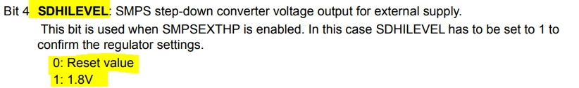

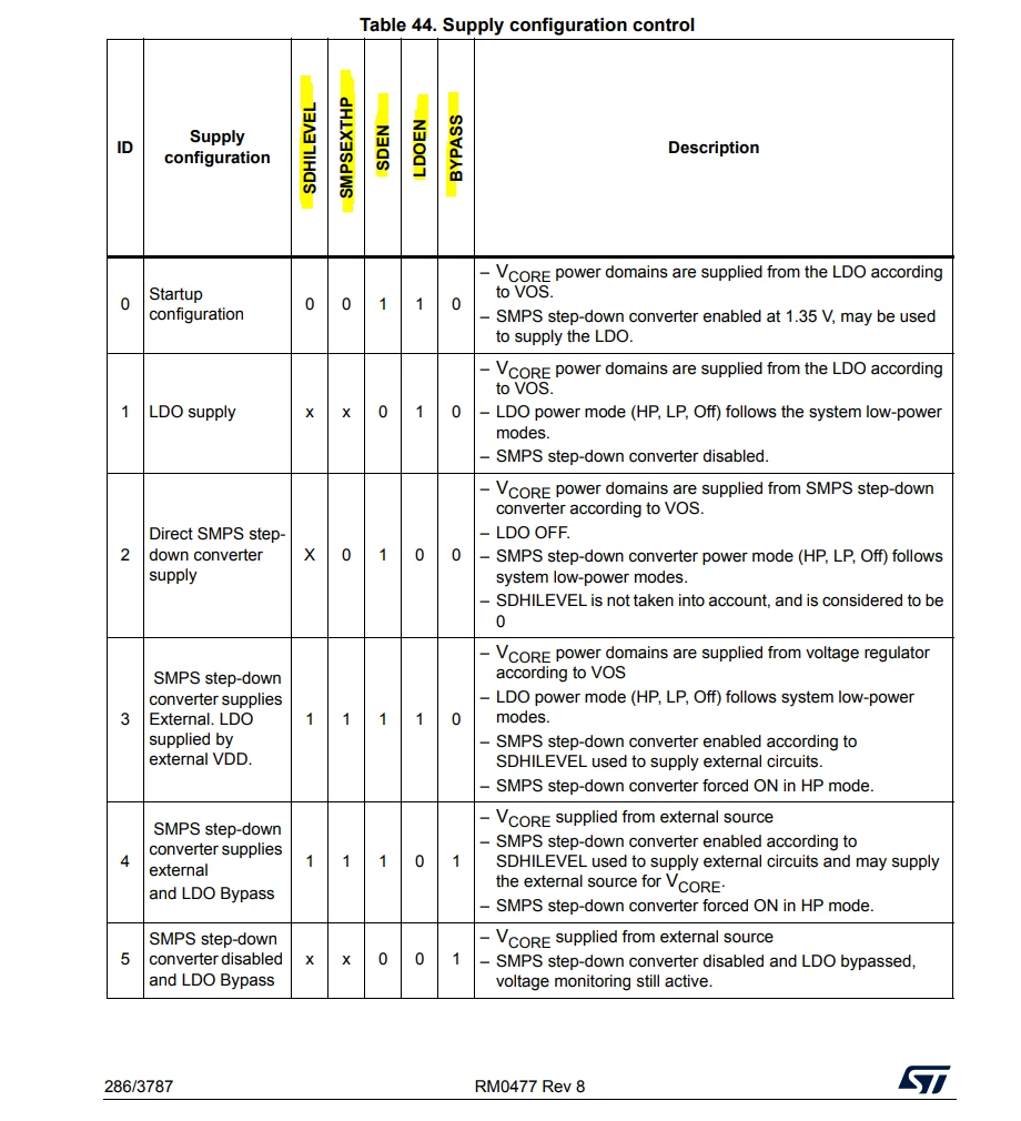

Depending on the mode you wish to work in,
you need to properly set the bits (SDHILEVEL, SMPSEXTHP, SDEN, LDOEN, BYPASS) found in Table 44. Supply Configuration Control in the Reference Manual RM0477
For the SDHILEVEL bit, which controls whether the SMPS outputs 1.8V or 1.2V
  • If this bit is set to 0 -> 1.2V
  • If it is set to 1 -> 1.8V

So there are two additional information, important for me:
1. SMPS may have different voltage than 1.8 / 2.5 V.
2. There are another power mode, not indicated in schematic: SMPS on, VCORE powered from SMPS but with LDO on.
Thanks for this.

Hi @Pawel Piwowarski,
When the LDO is on, it only powers the Vcore. You cannot power the Vcore with both the SMPS and the LDO at the same time.
