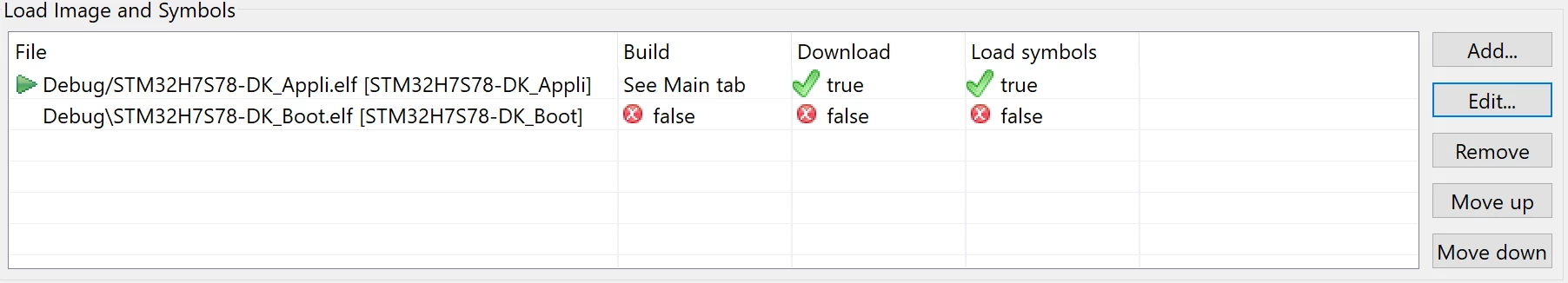

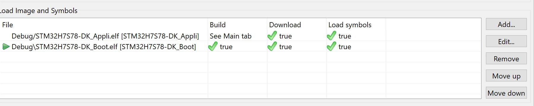

So I have a stm32cubeide project containing two sub projects
1. `STM32H7S78-DK_Appli`
2. `STM32H7S78-DK_Boot`
`STM32H7S78-DK_Boot` is not changing, code changes are in `STM32H7S78-DK_Appli`.

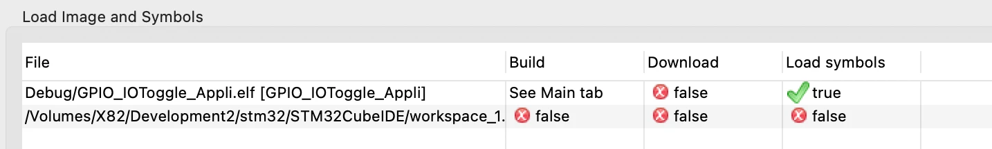

The only way I can find to debug that works is to flash `STM32H7S78-DK_Appli` and then `STM32H7S78-DK_Boot`:
If instead I only flash the `Appli` then it gets stuck in the HardFault_handler, if I then reset the board via the button I hit my breakpoint.
If I don't flash anything, then debugging works fine:
Is there some trick to getting debugging working when just flashing the `Appli`, I have tried the different "Reset Behaviours" but that seems to have no impact.
Thanks
Andy

Hi @CMYL
Thanks for the reply but what I am saying is that even if the boot is flashed, then just flashing the appli doesn't work unless I press the reset button on the board.
So taken the state that the boot is already flashed, the following work with debugging:
1. Don't flash either.
2. Flash Appli then Boot.
The following does not work (stuck in HardFault_handler, requires reboot via board button):
3. Flash Appli
Thanks
Andy

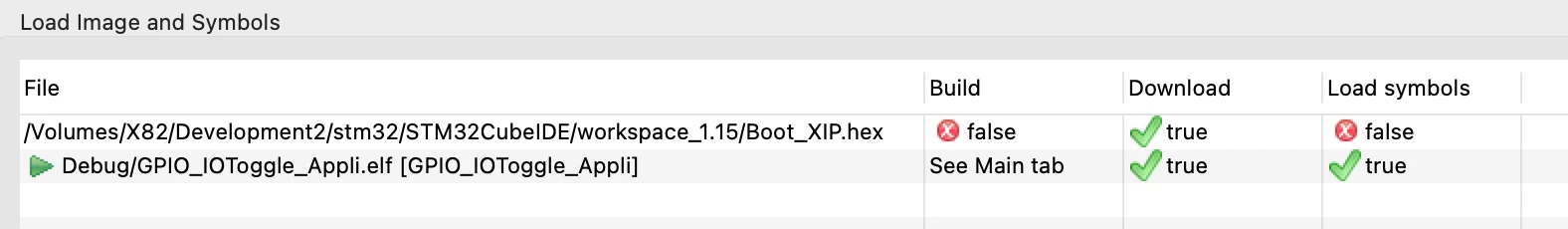

So I could not find anything in the IOC to generate the code so thought I would grab an example, GPIO_IOToggle.
This example uses the `Boot_XIP.hex` from https://github.com/STMicroelectronics/STM32CubeH7RS/tree/main/Projects/STM32H7S78-DK/Templates/Template_XIP

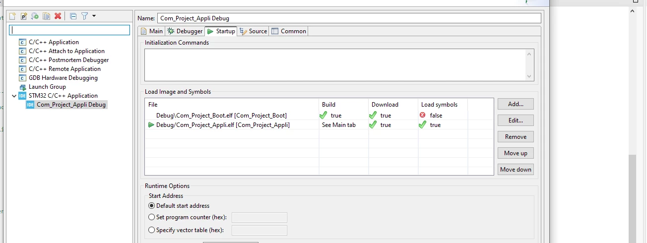

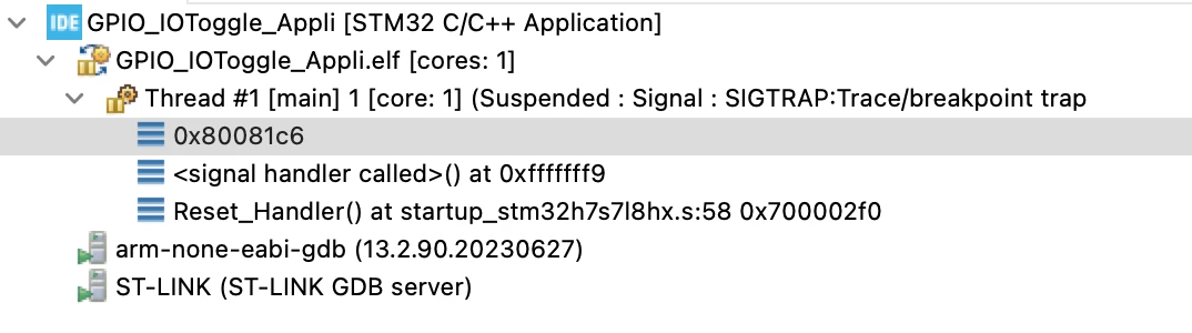

First issue, if I follow the instructions in the readme, which are like the instructions from @CMYL above and add the boot before the application as follows:

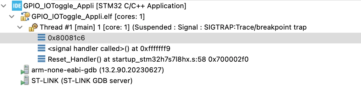

We get this:
I cannot continue the debugger from that.

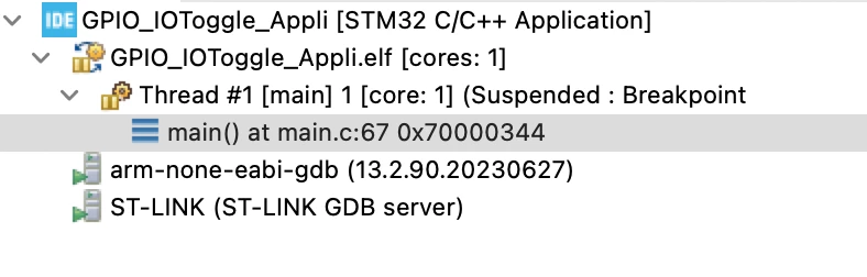

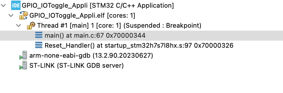

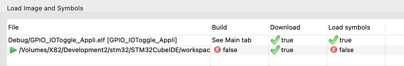

If I set up so that the boot comes after the appli:
Then everything works, we hit my breakpoint:

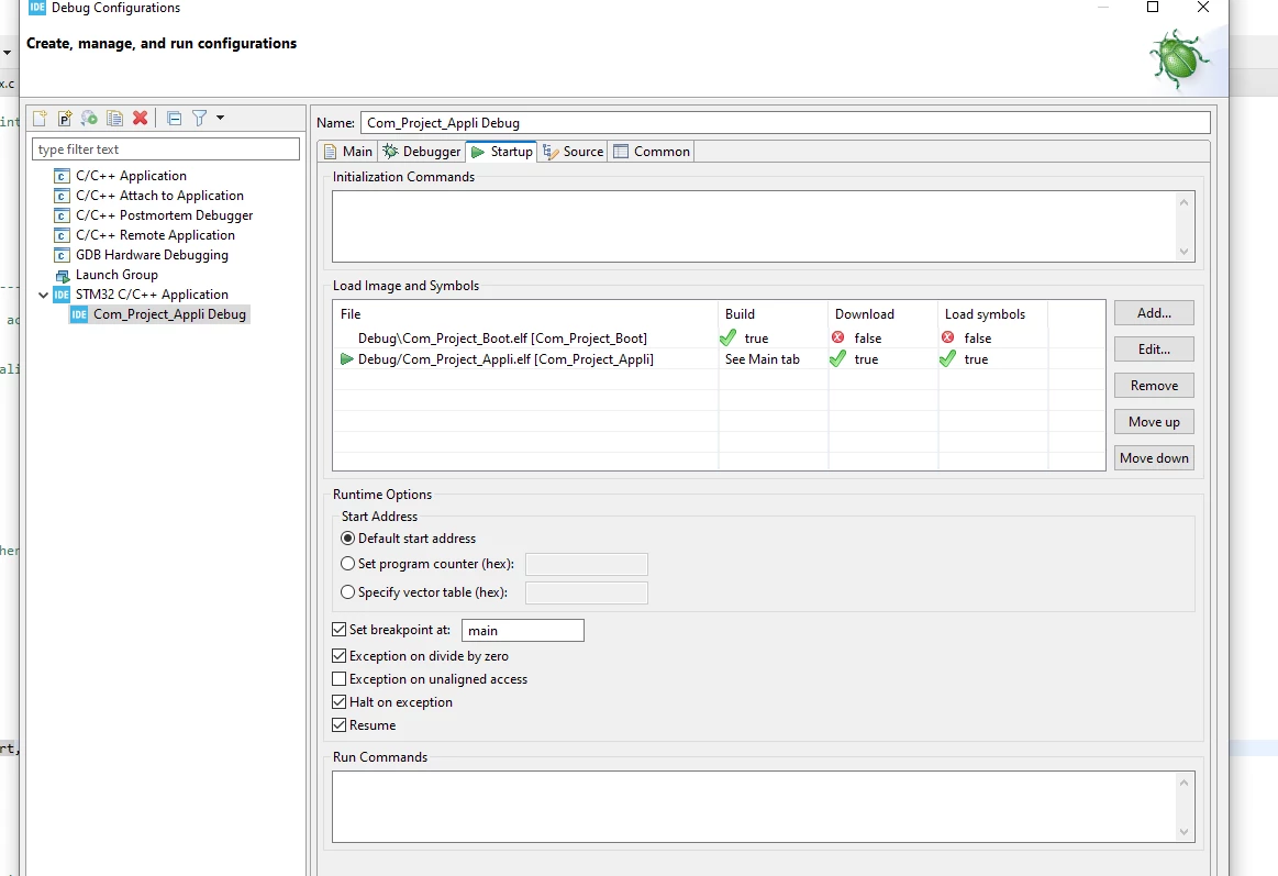

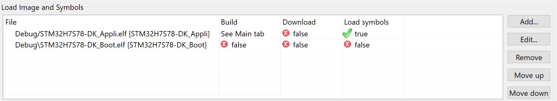

If I then set it up so that the boot is not flashed:
We get the same issue we saw when the boot was before the appli in the list above:

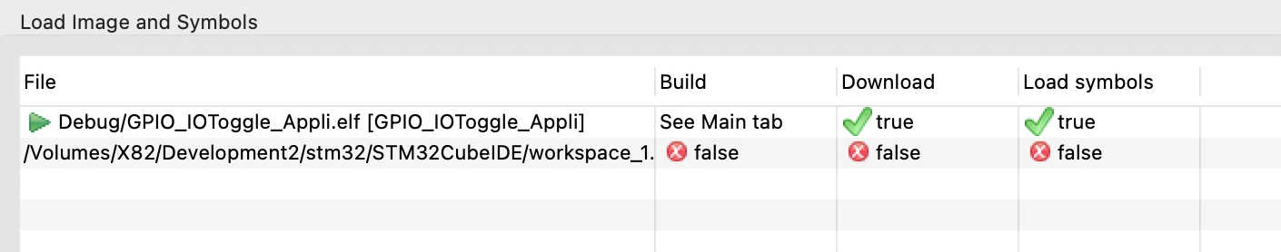

For the final test I set it up with no flashing:
And everything works:
So I am seeing the same sort of issues using the ToughGFX project and also a  ST example project.
ACapo.1
ACapo.1Author
April 18, 2024
In the readme of another example I found this:
To configure STM32CubeIDE Debug Configuration, you must do the following :
 1. Upload the template XIP
 2. Add the adequate external loader (MX66UW1G45G_STM32H7S78-DK.stldr file) in Project->Debugger Configuration
 3. Add in the startup the template_XIP_Boot in Project->Debugger Configuration
 4. Move up the application in the startup
This is actually saying that you need to move the application up in the list.
Maybe you always need to flash both?
