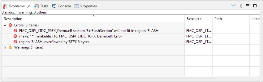

But when I want to add a new screen to the touchGfx project, I encounter the following error.

The two versions of the board have slight different pin designations for the OCTOSPI interface. Your current battle is with the LINKER, not the LOADER
Your error with "FLASH Overflowed" is indicative that the .LD used is *NOT* directing content into the right MEMORY section. You need to make sure the linker is provided with the correct .LD file, and that describes the MEMORY, and steers the SECTIONs into it.
You can review the .MAP if the linker succeeds to see where things were physically placed.

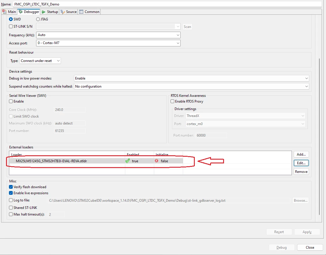

I copied the lines of code from the working example project and pasted them into the .ld file in my own project. In the .map file, I saw that touchgfx objects were moved to address 0x90000000. I tried to compile and install the project, but CubeIDE crashed and I could not programming. I then tried again by selecting REVB.stldr of the external loader and programmed both the MCU and the OctoSPI flash. The program did not work (no image appeared on the TFT screen), but at least I can program it properly. FMC, LTDC and touchgfx is working good but I think I missing something about the OctoSPI init codes.
It is very interesting that I cannot find a detailed explanation or application note on this subject. I will review the project again on Monday. Thank you for your support.
