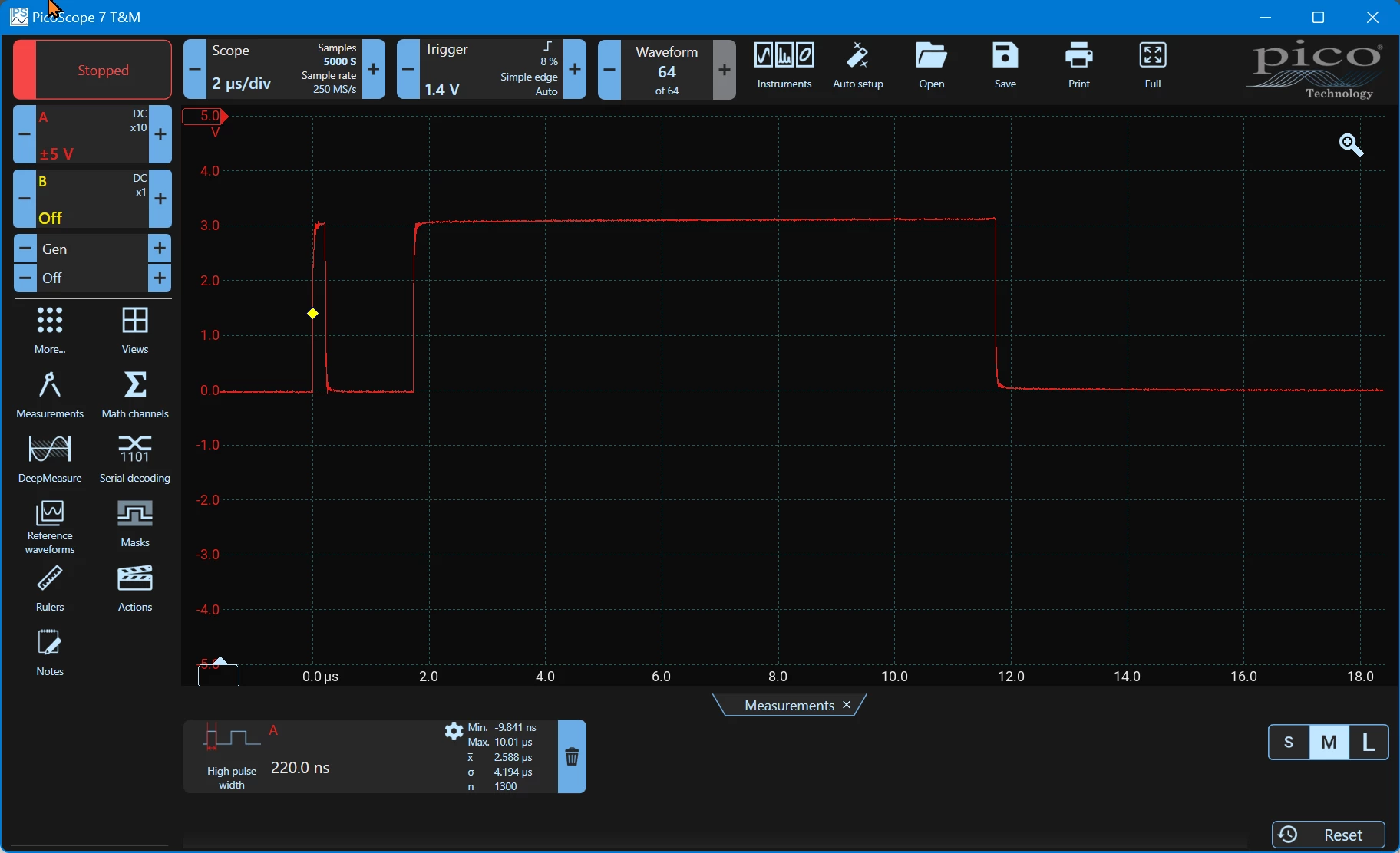

STM32H7B3I Timer 1 - Software intiated One Pulse Mode
I wish to produce a single pulse; lo-Hi delay Hi to Low.
I am using Timer 1 PB15 which is the complementary output timer Channel 3
I am using the timer in the following sequence
  1. Timer initialisation
  2. Set the ARR and CCR3 with the following
    ARR = 2241  (CCR4 + 1)
    CCR4 = 2240
  3. I execute   => HAL_TIM_PWM_Start_IT(&htim1, TIM_CHANNEL_3);
  4. Interrupt handler stops the timer => HAL_TIM_PWM_Stop_IT(&htim1, TIM_CHANNEL_3);
The correct width pulse is produced.
However if I don't use the interrupt to stop the timer the timer does not set the
output to reset state when the interrupt is initiated.
Thus the duration of the pulse produced is contingent upon the interrupt "clearing" the timer output PB15.
I do not want to use interrupts to produce the pulse as I want the pulse width to be accurate with very little jitter.
I have tried a heap of different configs to solve the problem and have been on stack exchange and this forum, but I can't figure out what I'm doing wrong.

Here is the code to initiate a pulse:
__inline void impulseGen(const float pulseWidth_ms)
	uint16_t pulseWidthCount;
	pulseWidthCount	= (uint16_t)(ms_to_count_tim1 * pulseWidth_ms);
	htim1.Instance->ARR = (uint32_t)(pulseWidthCount + 1);
	htim1.Instance->CCR3 = pulseWidthCount;
	/* Enable the TIM Update interrupt */
	__HAL_TIM_ENABLE_IT(&htim1, TIM_IT_UPDATE);
	triggerLED_Start(200, IMP_LED_BLUE, false);

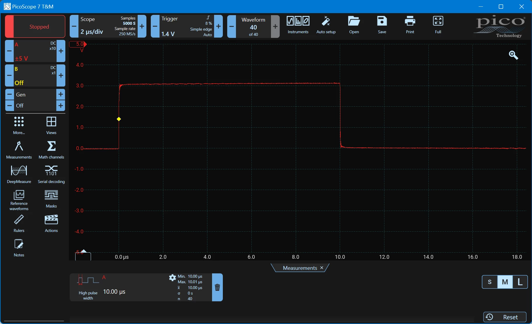

Hi Jan,

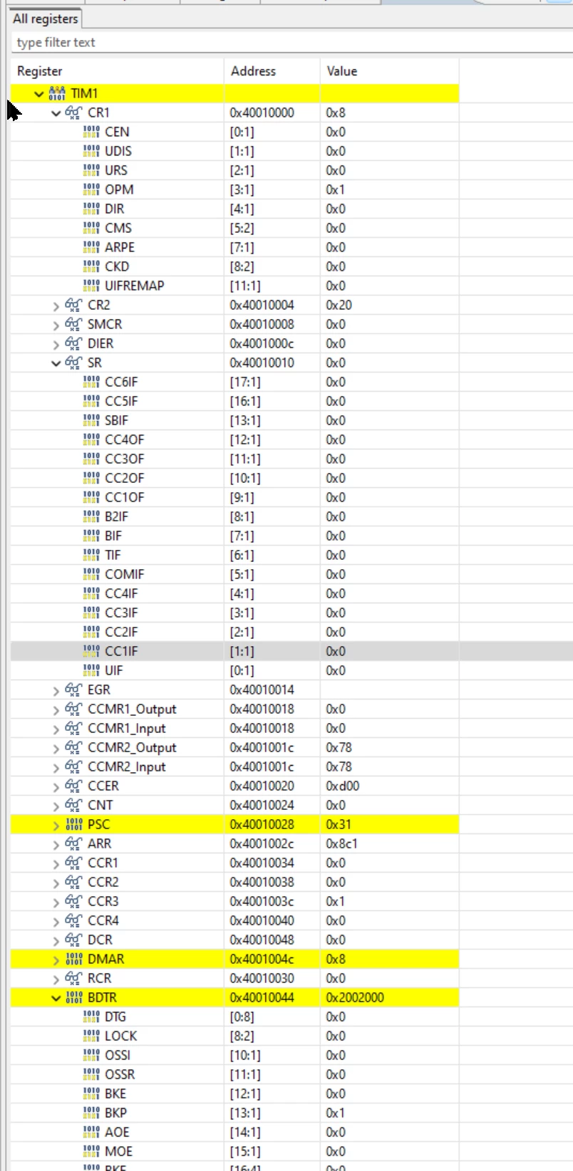

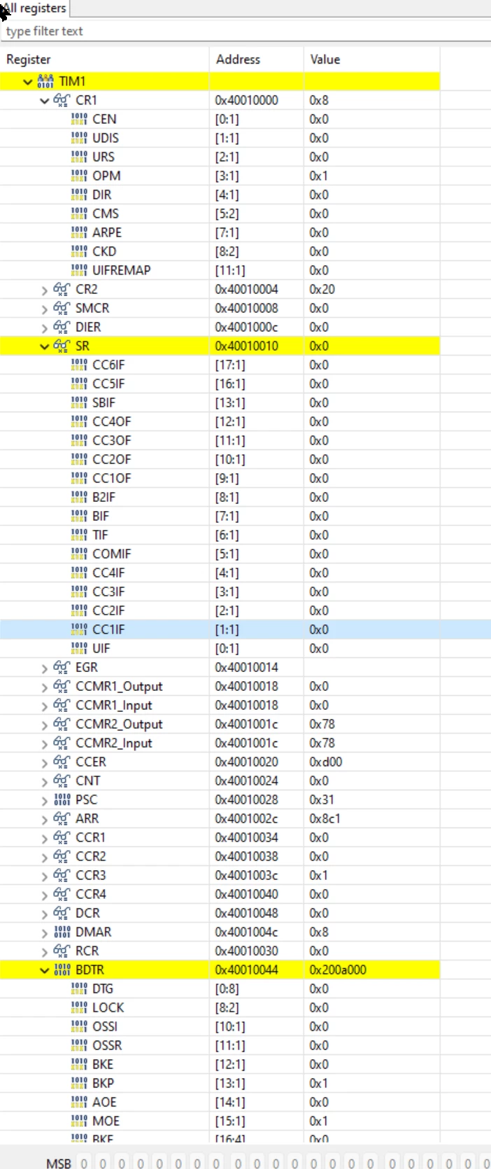

I have already tried you idea, but I gave it another go. Like the alternative using PWM1 it did produce one pulse, but when I did another StartPWM it did not produce a pulse it just stayed low.
I then took a snap shot of the Timer registers pre the start function both on the first time thru' then the second and compared them.
They were identical with the exception of the BTDR MOE bit Master output enable, being set. Resetting this bit prior to the second run made no difference.
So we had the timer in an identical state as read by STM32CubeIDE SFR monitor yet behaving differently from an intial run to repeated runs. Hmmm!! I thought to myself. What to do?
I made a copy of the timer initialisation function and then placed it before the StartPWM function and voila it works.  I then used a process of elimination to determine what part of the initialisation function "did the job."
Turns out the code I added to reverse the polarity of the complementary output must be executed before each StartPWM:

So I placed this before the StartPWM function and voila, it works.
PULSE GENERATION FUNCTION
*		PENDULUM IMPULSE GENERATOR												 		*
	MX_TIM1_Init();
	htim1.Instance->CCR3 = 1; /* pulseWidthCount; */
	/* Set the complementary OP polarity for ch 3
	 * will not do repeat runs correctly without this */
	htim1.Instance->CCER = 0xd00;
	HAL_TIM_PWM_Start(&htim1, TIM_CHANNEL_3);
The observant programmer looking at the Timer registers would have noted that this value 0xd00 was set in the register before each StartPWM command, so why do I have to set it before every start as it appears to be already set from initialisation.  I also inspected the memory location with the memory browser and found the value 0xd00 was set prior to each start command.
Could this be a silicon glitch?  The register has the correct value, but somehow it ignores it.
Regards
Rob
Timer 1 SFR's
Initial Run
Repeat Runs
7 replies

Timer 1 SFR's
Initial Run
Repeat Runs

I did some more checking and found that I was getting a "runt" pulse at the start of the sequence viz:
The cause of this pulse is the   TIM_CCxChannelCmd which sets the CCER register at line 12.
void TIM_CCxChannelCmd(TIM_TypeDef *TIMx, uint32_t Channel, uint32_t ChannelState)
 uint32_t tmp;
 /* Check the parameters */
 assert_param(IS_TIM_CC1_INSTANCE(TIMx));
 assert_param(IS_TIM_CHANNELS(Channel));
 tmp = TIM_CCER_CC1E << (Channel & 0x1FU); /* 0x1FU = 31 bits max shift */
 /* Reset the CCxE Bit */
// TIMx->CCER &= ~tmp; /* debug rjg */
 /* Set or reset the CCxE Bit */
 TIMx->CCER |= (uint32_t)(ChannelState << (Channel & 0x1FU)); /* 0x1FU = 31 bits max shift */
Commenting out this line removed the runt pulse:
The final code I ended up with is attached.
