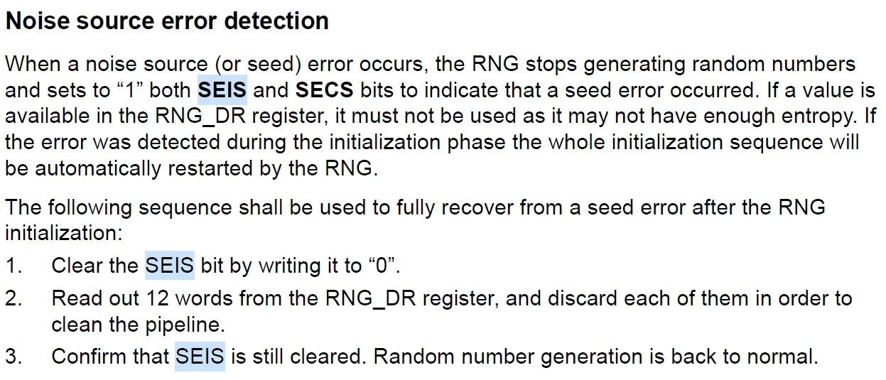

Hi
I'm using the Random Number Generator in interrupt mode and am getting HAL_RNG_ERROR_SEED errors. I'm not getting clock errors. I use HAL to drive the rng.
The errors are quite infrequent, I don't have stats but probably 1 in 100000.
Are these errors to be expected or am I potentially doing something wrong?
I am running the CPU at 280 MHz. The clock settings are implemented by HAL and I haven't changed these.
The problem I have is that to clear the error you have to restart the rng which take up to 200 ms.
The entropy of the numbers isn't critical in my app as I'm only using the rng to purterbate test data around a mean. So I am thinking that I could just let the rng run without resetting it.

On the question of recovering from a seed error there is a new HAL function: HAL_RNGEx_RecoverSeedError which was added in version 1.9 of the HAL Drivers. the code for this is:

Seems like seed errors can occur and you need to monitor for them if you want the advertised randomness out of the peripheral. HAL does this for you. Seems like they should be incredibly infrequent, however, but definitely a finite probability.
The recovery sequence doesn't seem like it should take 200ms. But maybe it does.

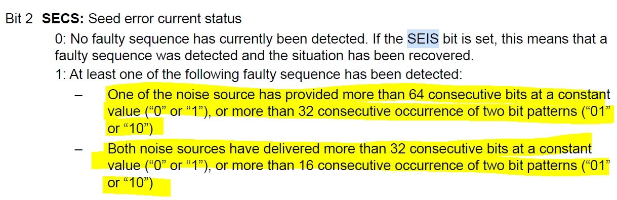

Doesn't sound right to me. If I read the reasons correctly, there are 16+4 reasons for the error, all with probability of 1/2^64, resulting probability is roughly 10^18. Assuming sampling in the order of 10s of MHz, the error should occur roughly once in 10^10 seconds, i.e. 300 years.
This and also the long recovery time - whatever it means and entails - indicates something wrong either in RNG setup or in the circumstances. The RNG in 'H7 is an overcomplicated beast and it appears that it contains numerous obscure ways to problems (e.g. "magic numbers").

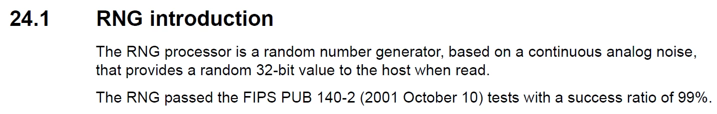

March 29, 2022
> ST claim that the RNG is a "True" random number generator and certainly imply the output is purely random not just the thermal noise source they use.
Where do they claim this?
Here's what they have to say in the F4 manual. It says nothing about a "true random." As the success ratio isn't 100%, presumably they're implying it is not perfect.

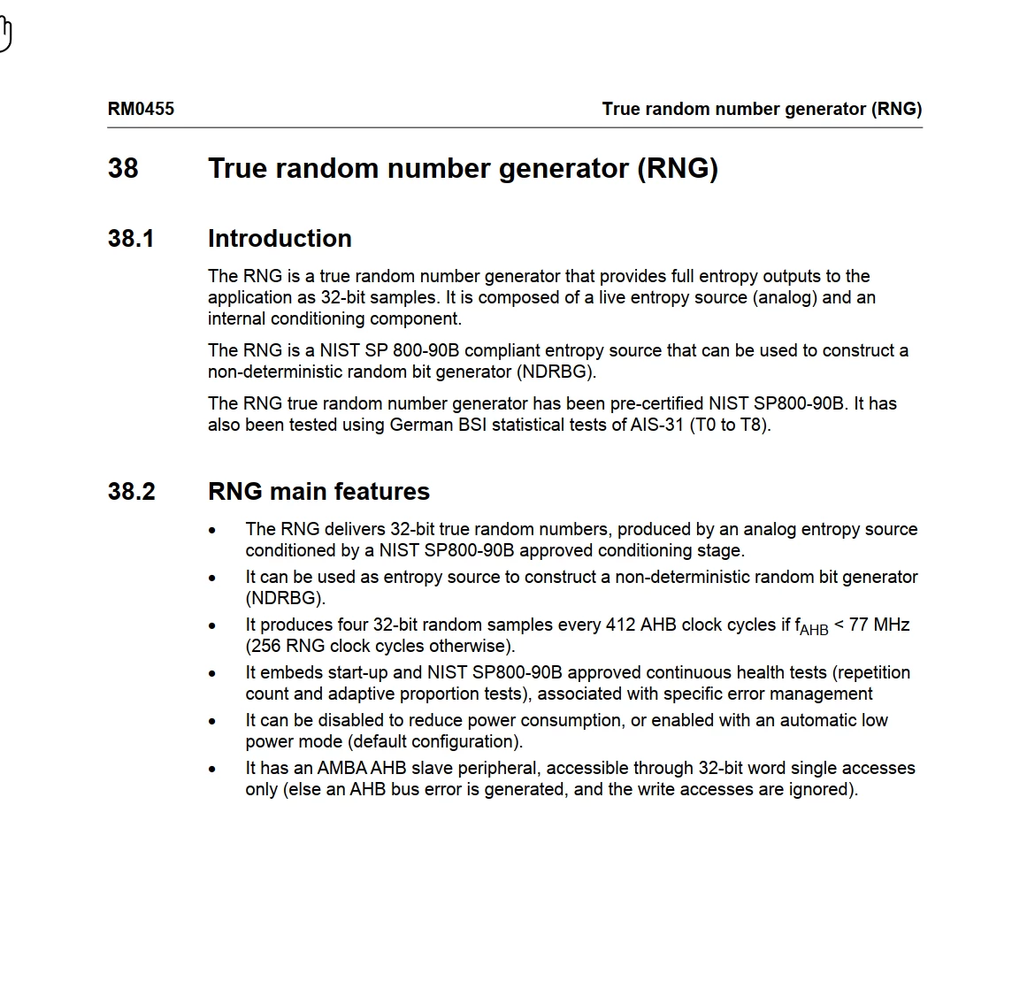

Garnett.Robert
Senior III
March 30, 2022
Hi TDK
It is stated in RM0455 The Manual for the H7. I never mentioned an F4. The exact processor I am using is in the title of my post. I always put the part no of the processor in question in the title whenever it is relevant.
It seems pretty clear to me that they are claiming it is a "True" random number generator. I have raised a support ticket on this, hopefully they will explain it.

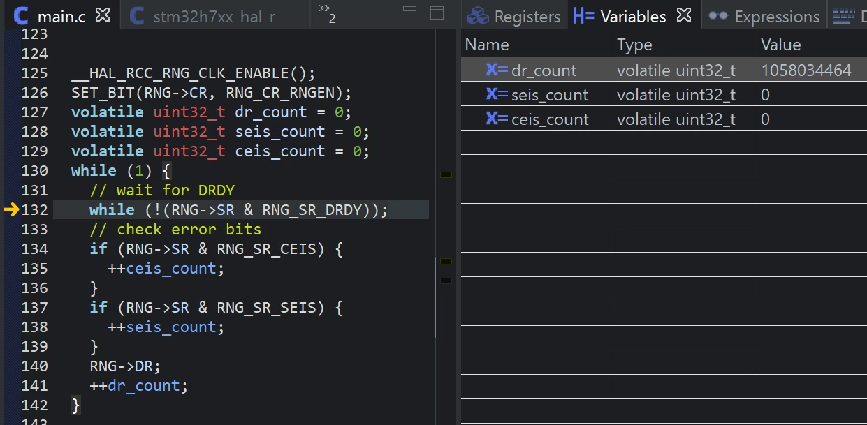

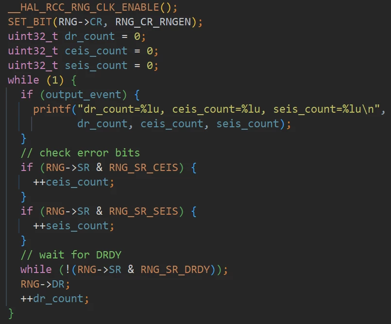

March 29, 2022
FWIW, I tested both an STM32F429 and an STM32H743 and couldn't get any error flags after hundreds of millions of samples, which is way less frequent than you're reporting. The RNG peripheral is different on the H7 compared to the F4. Note that the clock source feeding the RNG has some requirements, otherwise those flags will be tripped. Could be a clock thing.
H743:
F429:
[03:40.081125] dr_count=251392404, ceis_count=0, seis_count=0
