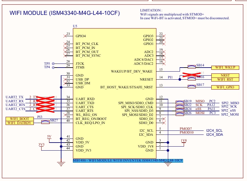

I am trying to use the Clock and weather application code that has some driver for wifi to test the module but it seems the net_conf_es_wifi_spi.c from the driver is trying to init SPI4 instead of SPI2 as per the schematics on st.com website.
why is there a difference in SPI and other GPIO pins? what is the correct pins that needs to be initialised?

I've Just downloaded the Last version of the STM32CubeH7 (V1.12.1). And it seems to be working fine (it use the correct initialization code for pinot and spi2...) please try using the Last version.
PS: it seems to me that you are using the project dedicated for the STM32H7B3I-EVAL and not the one dedicated for the STM32H7B3I-DK.

Thank you @STTwo-32 for checking it out.  The file I shared is part of "clock and weather app" in demonstrations folder under the device support packages. But it doesnt work out of the box and has PIN configurations wrong/outdated.I have attached the original one in this post.
Actually I was able to use a different model driver from github and was able to get some sort of connection working. But without proper documentation and some basic drivers Its hard to debug.
