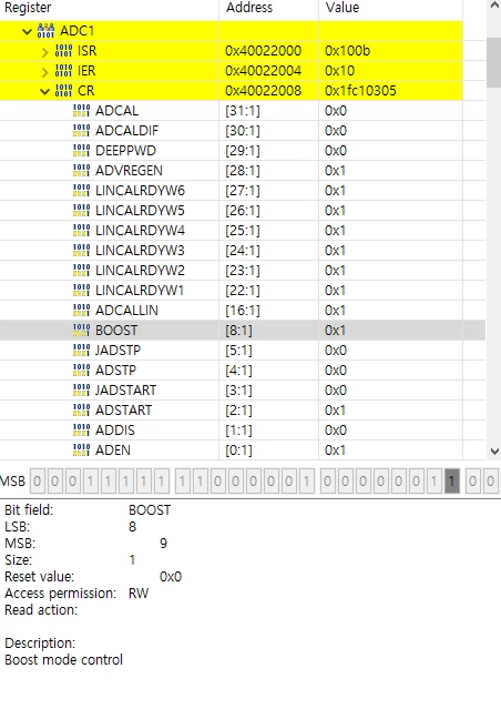

I'm checking the ADC operation with STM32H7B3I-DK board.

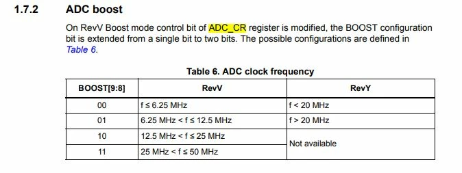

To set adc clock frequency up to 50MHz​, i tried to change BOOST bits of ADC_CR register.
However, unlike the rm0455 document that states that bits 8 and 9 (BOOST bits region) can be set, when checking in debugging mode in the IDE tool, only bit 8 seemed to be changeable.
I want to know the difference between the contents of the datasheet and the status shown in the register status window in debugging mode.

Hello @SPark.28​ ,
There is a difference and change between the "STM32H7 silicon Rev Y" and Rev above in the ADC Boost setting.
This is not a bug, it is an intentional change, and it is supported in the HAL/LL (by reading the device ID before applying the right register setting).
Main difference between revision V and revision Y is highlighted in this dedicated AN5312
