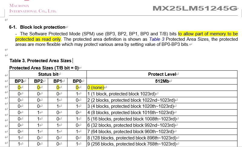

In at least one of the examples I think you blindly wrote register content, so any non-volatile bits would be gone.
The block lock is more likely to result in Erase or Writes failing. Doing a Write Enable typically doesn't infer an address.

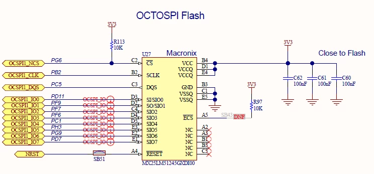

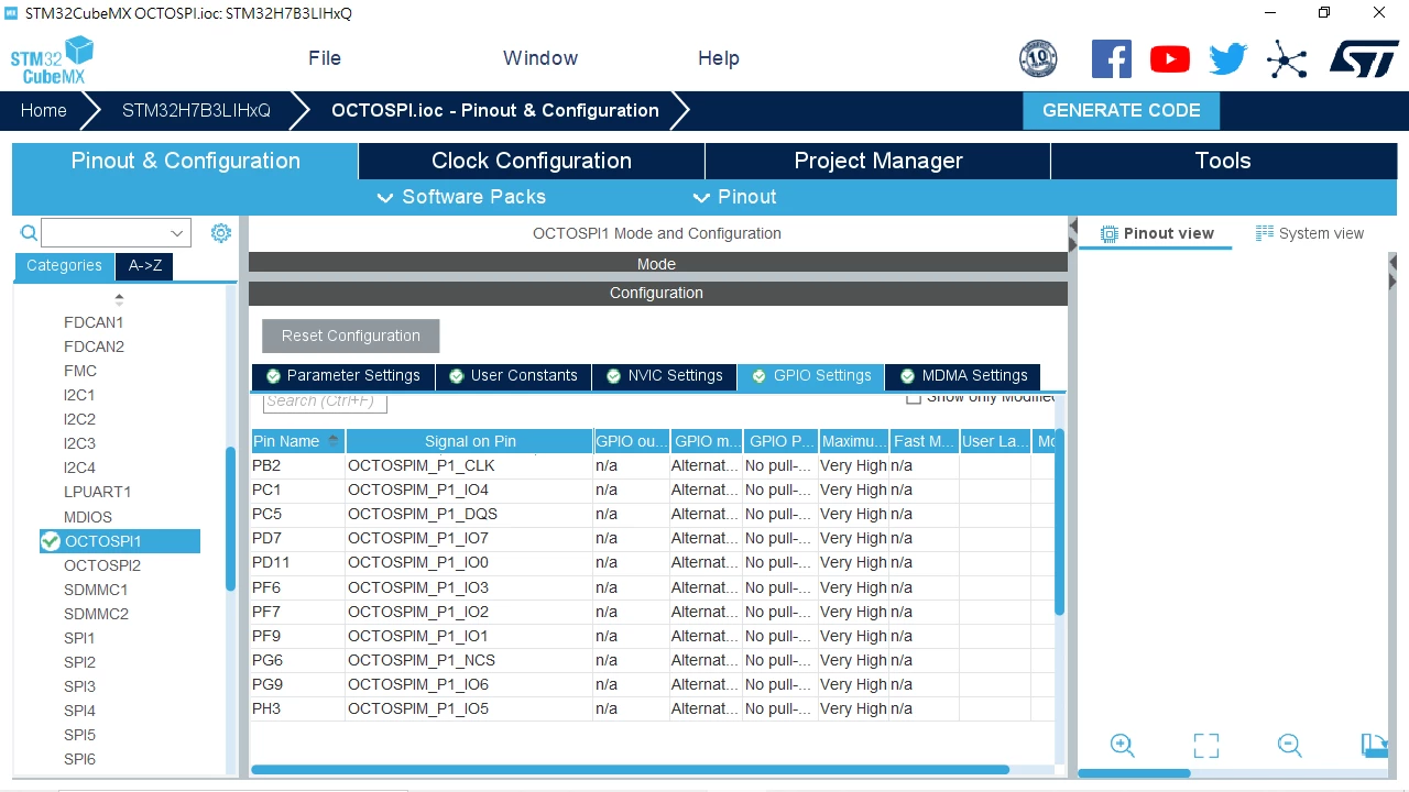

I connected the pin according to stm32H7B3I_Schematic.pdf, and I have repeatedly confirmed that the pin is correct, so it should be correct...
The picture below is the pin of stm32cube and STM32H7B3 OctoSPI Flash Schematic pdf.

4. Since I am a newcomer and have only recently started learning, I am guessing whether the issue could be related to Block lock protection?
