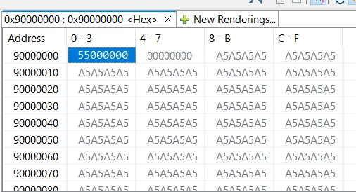

During a project we are using the microcontroller STM32H7B0RBT6 with QSPI PSRAM APS6404L-3SQR , it works fine in indirect mode either in quad read and quad write, but the issue is with the write in memory mapped mode when trying to write less than 8 byte, one for example (*((uint8_t*) (0x90000010))=0x55;) the 7 others  bytes are zeroed it seems that the write accept only 8 bytes if the data is less than 8 the other bytes are zeroed as you can see :
instead written 8 bytes (*((uint64_t*) (0x90000010))=0xA5A5A5A5A5A5A5A5ULL;) works fine !!
Did someone face a similar problem could please provide some suggestions to do, thanks,

There is an errata "Memory-mapped write error response when DQS output is disabled". So with this errata we need to enable the DQS when doing memory mapped writes even if the memory do not support DQS. This is the workaround as you did.
So when you do a 8-16-32 bit write , the OCTOSPI will output 64-bit and mask the rest using DQS pin. The problem is if the memory do not support DQS (which is in our case), the rest of the AXI data will be written to the memory. so if you write : (*((uint8_t*) (0x90000000))=0x55;) 0x90000000 will be written correctly but the data from address 0x90000001-0x90000007 will be corrupted.

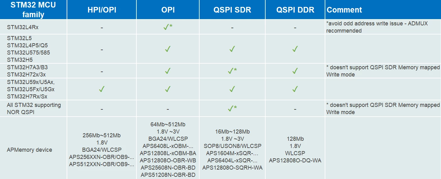

PS: Overview of IoT RAM (QSPI, OPI  & HPI PSRAM) support
STM32 MCU familyHPI/OPIOPIQSPI SDRQSPI DDRComment
STM32L4Rx-✓*--*avoid odd address write issue - ADMUX recommended
STM32L5
STM32L4P5/Q5
STM32U575/585
STM32H5
STM32H7A3/B3
STM32H72x/3x
-✓✓*✓* doesn't support QSPI SDR Memory mapped Write mode
STM32U59x/U5Ax, STM32U5Fx/U5Gx
STM32H7Rx/Sx
All STM32 supporting NOR QSPI--✓*-* doesn't support QSPI SDR Memory mapped Write mode
