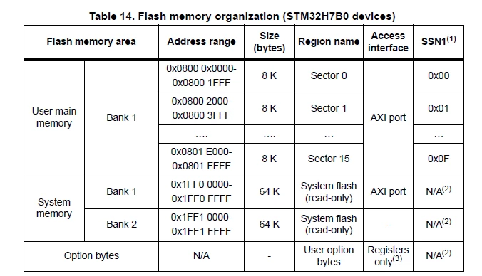

[STM32H7B0] Typo found in RM0455 - Does it have OTP Area?
There is a typo in Table 14 in page 153. It is mentioned in different places that STM32H7B0 supports OTP but in this table it is not mentioned!
Could you please confirm that this variant supports OTP?

Hello @Ayoub Cheggari,
Indeed, it is supported. You can refer to Table 17. Flash memory OTP organization

Thanks for replying!
So you confirm that there is a typo in Table 14?
Semantically if the tables are describing different things, probably not..
Do you feel the details conflict or overlap?

Thanks for replying! I am saying this because I usually use tha Table to define what is supported or not. Now it's clear to me that it's supported.

Hi @Ayoub Cheggari
Following your request, I have submitted an internal ticket 158923 to include OTP area in Table 14. and Table 15. I hope it will enhance our customers' visibility of information and help them better understand it. Even though it is supported in all products covered in this reference manual.
