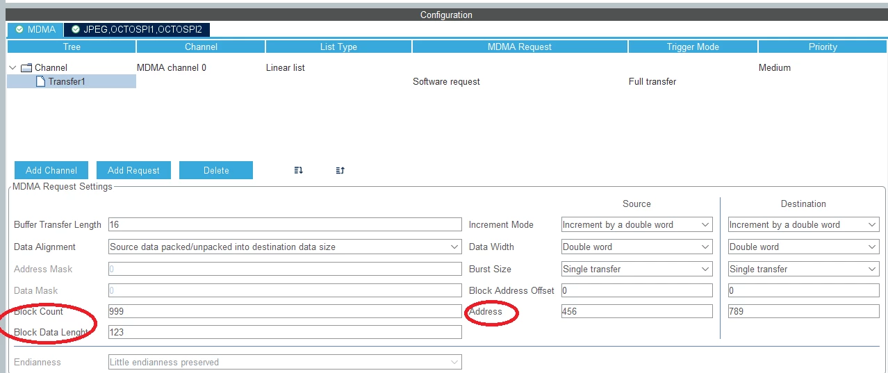

OGhis
OGhisAuthor
Senior
August 27, 2024
We didn't really find the error, but we are now using MXcube for configuration.
There are some parameters we don't understand:
In mxCube, we can enter the source and destination address along with “block Count” and “Block data Length” but nothing is done with these values during code generation.
Is this normal or a bug in mxCube?
The “buffer transfer length” what does this value mean?
