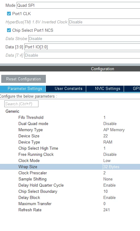

We try to send an receive data to the external APS6404 RAM.
Therefore we read the application note AN5050 and copy the function from page 55 (7.2.5).
At first the function HAL_RCCEx_OCTOSPIDelayConfig() we cannot find in the library.
What is correct function what we must us than or what we must change in the source code?
Without executing the function DelayBlock_Calibration() the MCU blocks when we read some data.

None of your suggestions meet our expectations.
- The  DLYB_OSPI_PSRAM_ExhaustiveTuning example, our STM32H7B0VBTx has no DLYB option.

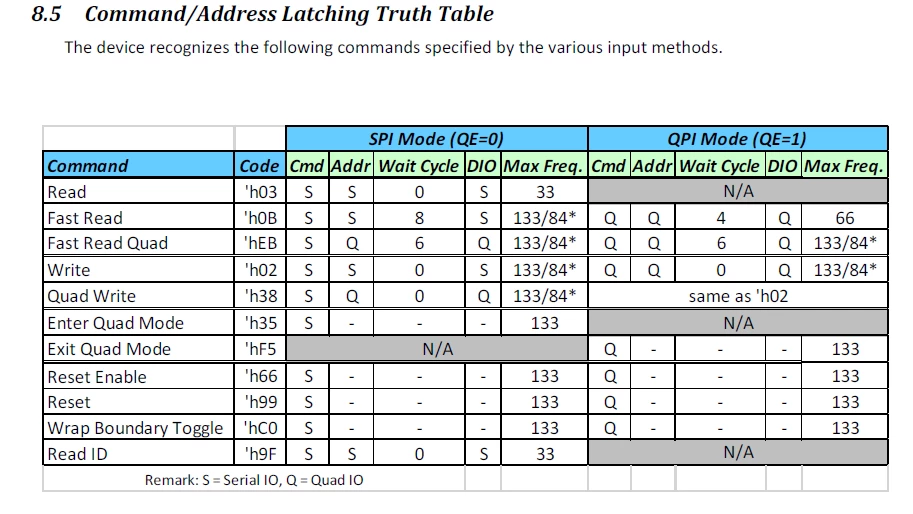

- The project use an APS6408L but we use an APS6404L-3SQR-SN has only 4 data bits.
OSPI examples with STM32H7 examples is for HyperRam chips and not QSPI
What we must change in the sCommand?  (we want to use it in memory mapped mode)

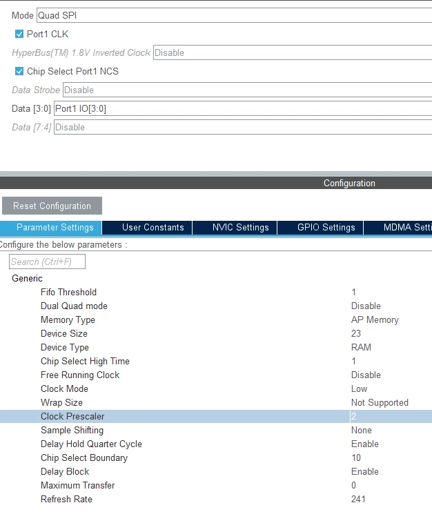

 if (HAL_OSPI_MemoryMapped(&hospi1, &sMemMappedCfg) != HAL_OK) { Error_Handler(); }
Are these settings coorect?
Btw: when executing the commands, we don't have any signal of the QSPI bus

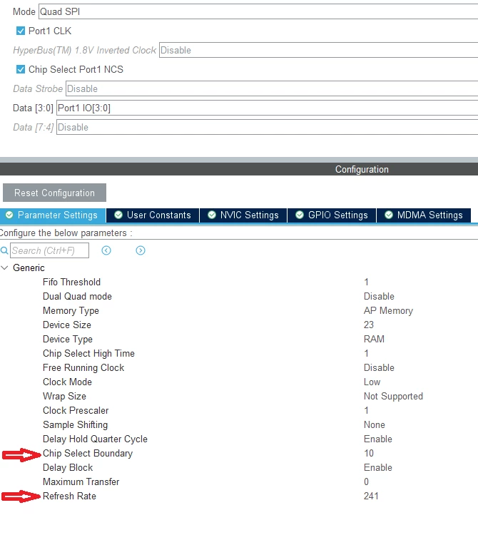

Hi @OGhis ,
Thank you for coming back to the community and I apologize that my suggestions did not meet your expectations.
About the settings: Device Size defines the memory size in number of bytes = 2^(DEVSIZE+1).
For 8MBytes memory the Device Size must be configure 23 as mentioned in AN5050 table8.STM32CubeMX - Configuration of OCTOSPI parameters.
Could you please try with this sCommand:

We seen now signals on all the I/O pins of the AP6404, but when we write an read back the data we have always the same data 0x88. (same data over the hole memory size, started from address 0x90000000)
What else can we verify and what could still be misconfigured?

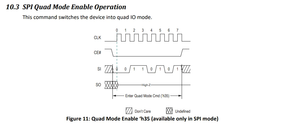

btw: the AP6404 has a command to put the chip in quad spi mode.
Why is this missing in your proposed source code?  => AP6404_ENTER_QUAD_MODE (0x35)

I only provided some configuration for read and write operation in memory mapped mode like that you shared, not all the code.
The SPI Quad mode enable operation command (0x35) is available only in SPI mode to switch the device into quad IO mode before enter in memory mapped:

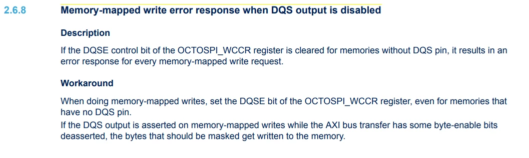

Concerning the 64 bit writes , there is an errata "Memory-mapped write error response when DQS output is disabled".
So with this errata we need to enable the DQS when doing memory mapped writes even if the memory do not support DQS. This is the workaround.
Now concerning products with AXI bus (OCTOSPI memory mapped region on AXI not AHB) the memory mapped write are always done in multiple of the AXI bus size (64-bit).
So when you do a 8-16-32 bit write , the OCTOSPI will output 64-bit and mask the rest using DQS pin.
The problem is if the memory do not support DQS (which is in our case), the rest of the AXI data will be written to the memory.

If I understand correctly, is there no other option than to write data to the AP6404 in 64 bit in my case due missing DQS pin?
Can we resolve the issue as follow
1 DMA in halfword mode for my ADC which stores the samples in the internal RAM memory buffer.
At the end of the tranfert we start a second DMA.
We have seen that the MDMA has a 64bit option.
With this MDMA we store the internal ADC RAM buffer to 0x900000000 in 64 bit mode and that writes the QSPI it to the AP6404.
To read back the samples, we start another MDMA in 64 bit mode to an internal RAM buffer. This buffer can then be used to send the samples via the USB interface.
Is this a good workarround solution for us?

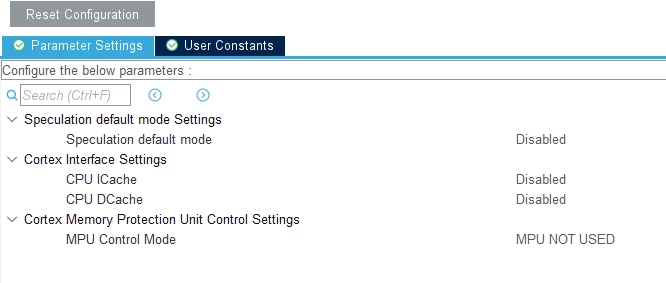

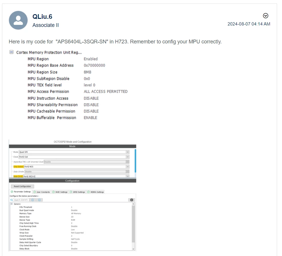

Which OCTOSPI frequency are you using? Could you please refer to the STM32H7B0 datasheet (OCTOSPI characteristics table) and to the memory datasheet and check whether the OCTOSPI frequency used is supported by the OCTOSPI interface and by the memory datasheet?
Is the cache is enabled? Please try to disable it?
Could you please take a look at this video and check MPU configuration. May this post help you.
Thank you.

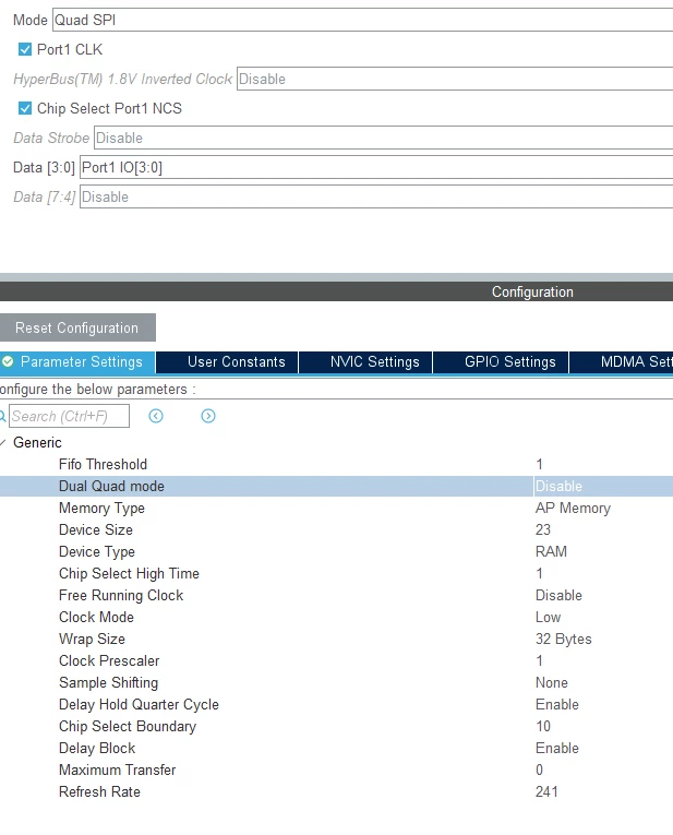

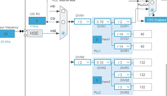

I had works at 132Mhz clock without any data error in the RAM.
What was so very strangs is when we set the clock at a lower frequency we having mutch more errors.
Yesterday it was working fine until we re-powered the MCU.
What we had changed:
- Wrap size to 32 byte
- Device size to 23 bit (8Mb)
- changed the clock from 80 to 132 Mhz.
Than in the software we had:
- reset the RAM chip
- set the RAM in 32 byte wrap mode
Maybe the RAM was in a different mode than we expected, due to the constant changes in RAM mode.
Are the settings for resetting the RAM and setting in Wrap 32 byte correct done? (see code)

Is there any change when you disable WRAP?
Is the cache is enabled? Could you please disable it?
Could you please check the MPU configuration? May this discussion can help you.
Thank you.
Kaouthar

We don't not way you ask to configure the MPU to resolve our issue.
Second the link and picture you send to us isn't not for our AP6404.
So let us step by step verify the configuration
With the code below we can write and read to the memory without any data error.
But therefore we must at each write cyclus wating with 40 NOP() otherwise the memory check will be fail.
So at first please verify at first if the commands for the configuration of the AP6404 in QSPI mode are correct.
The step we use are:
- exit from QSPI mode
- in SPI mode we reset the externel chip (not sure if this is correct done)
- Set the RAM in wrap bondary mode (this is disable, wont not works)
- set the QSPI RAM in QUAD mode.
- enable the memory mapping mode
The MCU works at 280MHz and the QSPI is set at 132 MHz

With the source code from my previous post, it seems to work with no additional delays while placing the data in the QSPI region memory (0x9000000).
But this only works if we make the write speed lower that the clock speed of the QSPI.
The failure of the write has something to do with the write speed.
How should we adjust the settings so that no subsequent write operation can happen before the QSPI has sent the data to the external memory?
In mxCube we have 2 parameter “Chip Select Boundary” and “Refresch Rate” which we don't understand how to adjust (probably has to do with this)
How we must calculate these values?
KDJEM.1
Technical Moderator
August 28, 2024
Hello @OGhis ,
- Chip select boundary (CSBOUND) configured depending on the memory datasheet. The chip select must go high when crossing the page boundary (2^CSBOUND) bytes defines the page size).
- Refresh rate (REFRESH) required for PSRAMs memories. The chip select must go high each (REFRECH x OCTOSPI clock cycles), configured depending on the memory datasheet.
- Sample shifting (SSHT) recommended to be enabled in STR mode and disabled in DTR mode.
- Delay hold quarter cycle (DHQC) enabled in DTR mode and disabled in STR mode.
For more information, I advise you to refer to AN5050 precisely 7.2.4 OCTOSPI configuration and parameter setting section.
Thank you.
Kaouthar
OGhis
OGhisAuthor
Senior
August 28, 2024
We have read several times the application note and follow the setting of section 7.4.2.
The only parameter we had changed was the "Refrech Rate" from 241 to 872. This because we working at 109Mhz and the datasheet of the APS6404L-3SQR-SN says that the refresh time was 8µs.
Than we have try all the combination of the parameters "Sample shifting" and "Delay hold quarter cycle"
The only combination that works is "Sample shifting" = None and "Delay hold quarter cycle" = Enable
Also we had try some other values for the parameters "Maximum transfert" and "chip select high time"
With all these parameter changes, the problem persists. (between 0 and 8 write and read back compare failure)
During the memory test, we do about 37.75 million read and write operations
When we decrease the QSPI clock have many times more failures (from 109 to 80 MHz, MCU clock was 280MHz)
When we decrease the MCU clock to 140MHz we must also decrease the QSPI clock to 108Mhz.
In this case after 100 memory test cycles we have no more errors.
The problem we have then is that we don't have enough CPU speed for the ADC. (At least 200Mhz)
When the CPU speed goes under the 200Mhz, the clock prescaler of the ADC has no option more to divide the clock by 1 or 2. We have need this to use a sample rate of 1 mega samples. Why the clock speed of the CPU affects the ADC is also very strange. The ADC has his own clock (48Mhz)
So it does have something to do with the QSPI clock and the write speed to the QSPI memory mapped address space.
Could it be when we write to the memory space that the MCU is not waiting long enough for the QSPI?
Or what else would trigger this problem?
