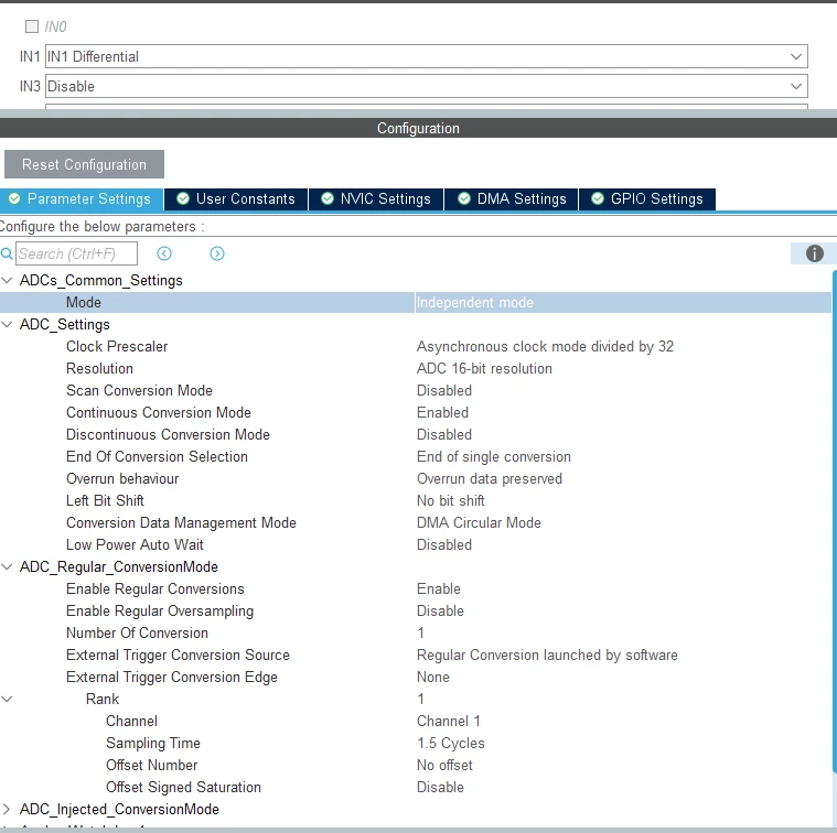

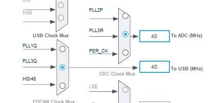

Hey,
We using an STM32H7B0 100 pins MCU.
With this mcu we will sampling 1 16 bit ADC input at 1 MHz and we using a DMA in circular mode for 1000 samples
The ADC clock works at 48Mhz, the clock precaler for the ADC is divided by 32 and the sample time is 1.5 cycles.
So, 48Mhz / 32 / 1.5 / 1000 = 1Mhz, but we when seen that the sample rate is only at 75Khz.
The 75Khz was measured with a GPIO toggle output pin in the HAL_ADC_ConvCpltCallback() end of single convertion call back.
What we doing wrong?

AScha.3
August 16, 2024
Your ADC clock is much too low, set divider to two.
The ADC needs some clocks to convert, 15 or so, plus sampling time ; and depending on source impedance you need longer sampling time, so set not the shortest possible, try 7.5 ; then you get about 1us sampling.
(48MHz /2 -> 24 / 20 clocks -> about 1 us ).
Just try - and read RM about the ADC. :)

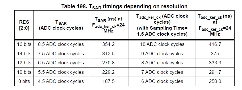

Just look at ds, how many clocks your ADC at the resolution you set needs, then add the sampling clocks to get total ADC conversion time. You cannot choose everything as you like, only certain steps are possible to set - obviously.
But you can choose the basic clock for ADC and the division of the clock, so by choosing a certain clock for the ADC and a sample time, you can adjust it.
Other way is, to make the conversion faster than needed, let's say 1.5...2 msps, then start the ADC by a timer at the desired frequency to get exactly the rate you want and adjust it just by the timer -> trigger the ADC at this rate.
That's the perfect way to get any sampling rate (as long, as the ADC is faster than the trigger you set, because it has to be ready for the next trigger in time.).

When we now caculate the sample time:
TCONV = Sampling time + 8.5 ADC clock cycles
TCONV = 32.5 + 8.5 = 41 cycles or 48 / 41 = 1.170 M samples.
For the ADC conversion we us a DMA in circular mode with a buffer size of 1000 samples.
Than we us the HAL_ADC_ConvCpltCallback() function to indicate when the 1000 sample are taken.
In this interrupt we let toggle an output port.
The frequentie on the output pin should be:
Freq I/O pin = Sample freq ADC / 1000 / 2    (2 here means, factor 2 due togglling)
Freq I/O pin = 1.170 mega sample / 1000 / 2
Freq I/O pin = 585.3 Hz.
We measure 292.7Hz on the I/O pin.
This is a factor 2 slower than calculated.
Can you explain us why this is a factor 2 slower? (sample rate is 585Khz and not 1.17 Mhz)

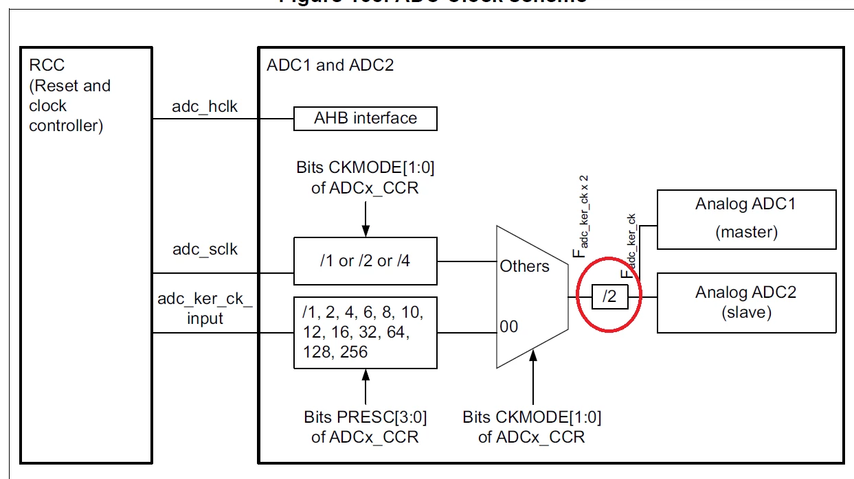

AScha.3
August 16, 2024
Hmmm... look in RM, ADC block picture, some ADC have internal /2 division, so running on half clock rate. Maybe depends on version of chip, V or Y or so. Check this.
And just try with shorter sampling time, to get about 24 cycles, and see, what happens.

August 17, 2024
When we reduce the sample time to 25 cycles we have the same issue. Sample rate is 2 times lower than the calculated sample rate.
So there is somthing internal that pre divide the ADC clock by 2.
==>  Maybe depends on version of chip, V or Y
Where i can find this information?

OGhis
OGhisAuthor
Senior
August 17, 2024
Thanks for the information
We cannot find the the single letter, V or Y or Z... on the chip.
But we found this in the datasheet. So the Clock of the ADC is always divided by 2.
For the 1 M sample rate we using now a timer and this works fine.
