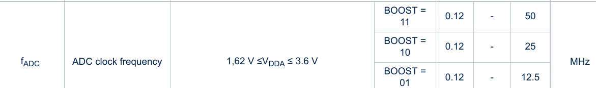

In the DEV13195 - Rev8 - Datasheet, section 6.3.21 16-bit ADC characteristics, table 93 ADC characteristics, page 143
It says the fADC max frequency is 50 MHz with boost mode activated

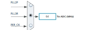

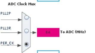

Is my comprehension correct ? because when using the ioc configurator just to check this configuration it does not work if the source frequency adc_sclk or adc_ker_ck_input is above 50MHz, either the synchonous mode selection is grayed out or the clock is in red in the clock configurator (see attached captures)

The  fadc_ker_ck maximum value is 50 Mhz , for boost11 ->
So whats your boost setting ?

According to the documentation the BOOST mode is not related to the voltage scale in DEV13195 - Rev8 - Datasheet, section 6.3.1 General operating conditions, Table 23. Maximum allowed clock frequencies, page 84 the max frequency for fadc_ker_ck is 50 MHz for VOS0 to VOS3
The Boost mode is selected in via the bits BOOST[1:0] in the ADC_CR register of ADC  RM0455 - Rev 11 - Reference manual, 27.6.3 ADC control register (ADC_CR), page 1015

It seems there is a limitation in the ioc editor for adc_sclk or adc_ker_ck_input, because if I use divider to set adc_sclk below 50 MHz, I am able to select synchonous mode selection, which is no longer grayed out in the adc clock source, and if i manually input 50 for the adc_ker_ck_input in the clock editor it is no more in error.
Actually I won't use the editor no more, and I want to use only HAL library, but I want to be sure to be able to use an adc_sclk source for ADC above 50 MHz but with the clock dividers the final fadc_ker_ck will be below 50 MHz
