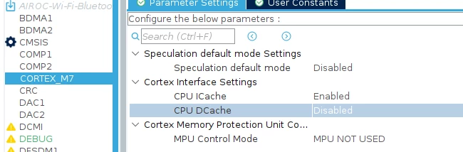

D-cache should not make things more difficult , so i recommend to not use it.
Just in Cube do not enable it, later can enable and do the cache management - was my idea, to make it more easy.

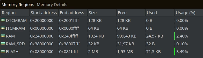

I forgot: you have to add this to the xxx_flash.ld file   (just before the comment line : /*Remove... )
 .RAM_SRD_sec :					/* (NOLOAD) <- no initialize */
 	. = ALIGN(32);
 *(.RAM_SRD_section)
 . = ALIGN(32);
 } >RAM_SRD
 /* Remove information from the compiler libraries */
And after mod the xxx_flash.ld file you see it is used ? ->
Now it should work.   8)

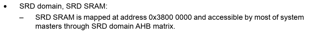

For bdma only SRD area is useful:
Now look at your xxx_FLASH.ld file and edit...add new section, if not there (i have no H7A3 with this, so i cannot just give you one);

//Per the reference manual (RM0455), BDMA only has access to SRD ram section
__attribute__((section(".RAM_SRD_section"))) ALIGN_32BYTES(std::uint8_t getFPCmd[]) = "abcdefghijklmnopqrstuvwxyz";
__attribute__((section("RAM_SRD_section"))) ALIGN_32BYTES(std::uint8_t getFPCmd[]) = "abcdefghijklmnopqrstuvwxyz";
 	. = ALIGN(32);
 *(.RAM_SRD_section)
 . = ALIGN(32);
 } >RAM_SRD
