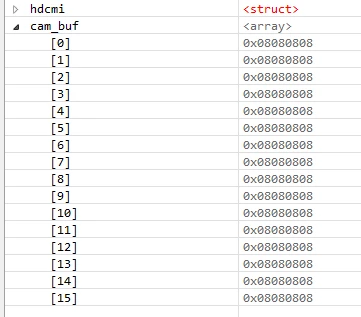

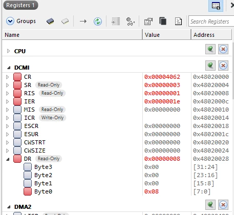

I configured camera module and can confirm that all data and syncro signals are correct. Frame buffer is 153600 bytes size for 320*240 16 bits image. DCMI is able to detect VSYNC and HSYNC pulses and generates interrupts, so framing is working as expected. DMA seems to work as well, I can see data in buffer. The problem is that I receive 1176 bytes of 0x08 and then all zeroes. According to debug info DCMI data register really gets 0x08 and 0x00 bytes, packs them to words and buffers for the further DMA transfer. I'm curios why port is not reading correctly? I tried to cover camera lens and tried set camera to transmit color bars in demo mode. Also played with master clock frequency changing pixel clock from 1.5 to 6 MHz. Result is always the same despite I see the real pixel data on bus with oscilloscope.

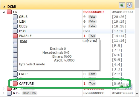

Could you please check if Capture bit is enabled in DCM_CR register?
Note that the DMA controller and all DCMI configuration registers must be programmed correctly before enabling the CAPTURE bit in DCMI_CR.
May be 8. DCMI application examples section shared in AN5020 can help you.

I believe that calling HAL_DCMI_Start_DMA function should enable CAPTURE bit in register, and it actually does:
I've read AN5020 and found official examples on Github, however there is no examples for H7A3 all that I found are targeted for F747 MCU.Also I can confirm that DCMI configured before sampling started and that DMA is confugured prior to DCMI initialization. Here is my code snippets:

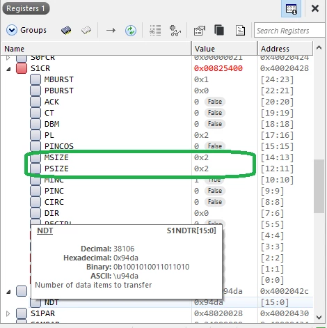

- If the PSIZE bits in DMA_SxCR register are "10"?
- The programmed value in DMA_SxNDTR must be a multiple of MSIZE or PSIZE.
Thank you.
Kaouthar
Dmitriy_LAuthor
Nov 10, 2023 4:30 PM UTC
Hi @KDJEM.1 ,
Sorry for the late responce, had some work on another project.
I've checked registers you mentioned above:
MSIZE and PSIZE both have 0x2 value. NDTR register seems to keep reminder of data that expected to be recieved from camera. Initial value 156300 bytes minus 1176 transferred gives 152424 or 38106 in uits of 32-bit words.
