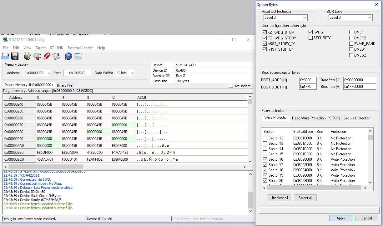

I was playing with a code once suddenly I could not send anything to MCU. Keil returns me multiple lines like this with different addresses:
"Contents mismatch at: 08040FE1H (Flash=FFH Required=00H) !"
The programming algorithm is fine.
In STLink Utility, I have noticed that write protection has been enabled (sectors 0-15 disabled, 16-31 enabled, 32-47 disabled, 48 - 63 enabled, and so on). I have tried to disable write protection entirely by STLink utility and CLI...no luck. The weird thing is that the address pointed by Keil is not in a protected area. I see that some sectors can be modified and some not (but they are not even marked as a protected! - like sector 32, which is not protected, but the content could not be changed during programming!).
When I tried to modificate write protection in CLI, only MSB of the value changes:
0x0000FFFF-> 0xFFFFFFFF -> 0x0000FFFF ... the LSB part stays the same.
It is a new MCU - is it possible it is a manufacturer issue?
Is it better to buy a new MCU or is there some workaround for this issue?
Cheers,
Rob

Did you try the same in STM32CubeProgrammer? It's newer. Might support the newer chips better.
Amel NASRI
August 24, 2020
+1 to @TDK​  proposal.
