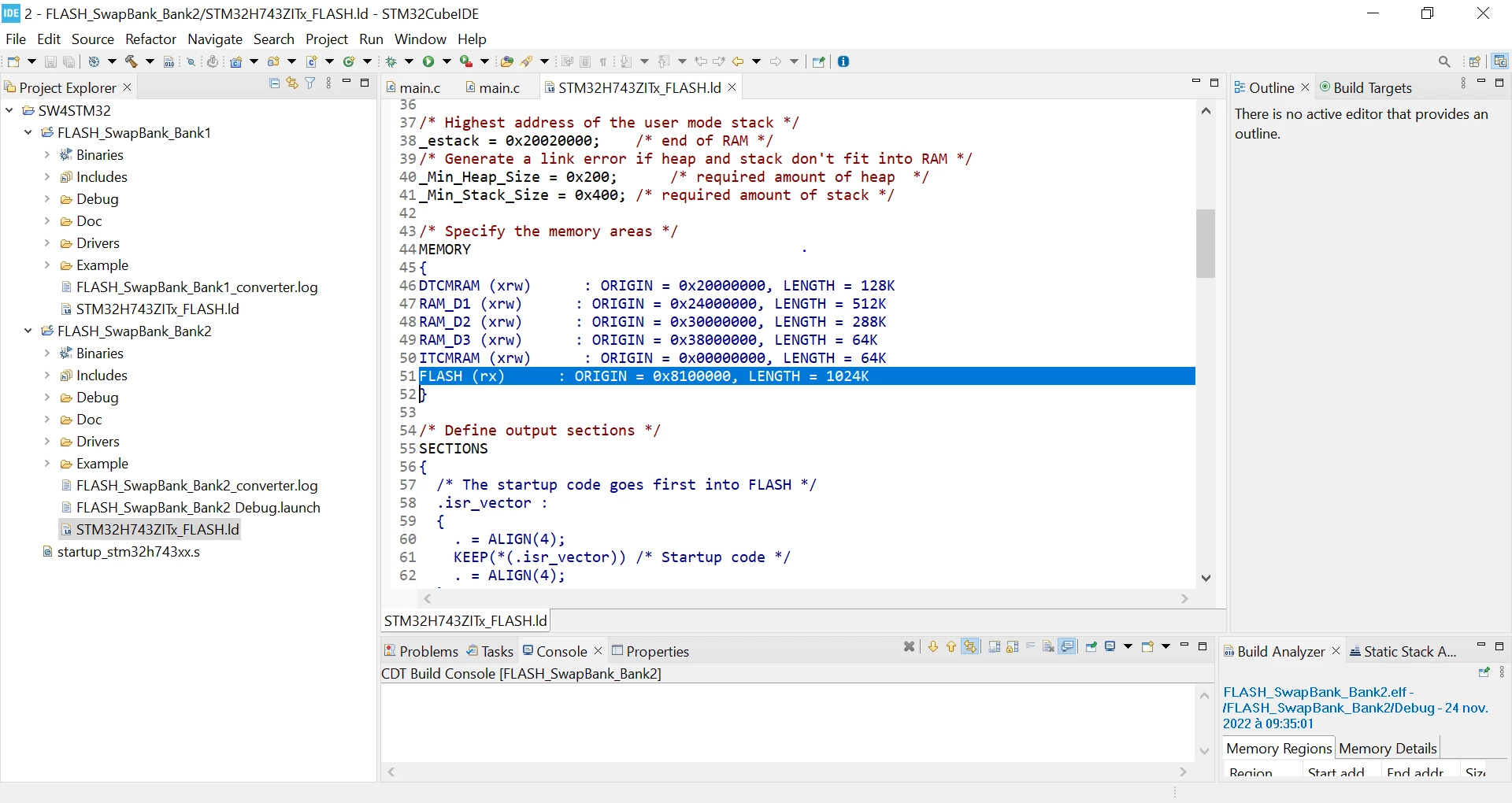

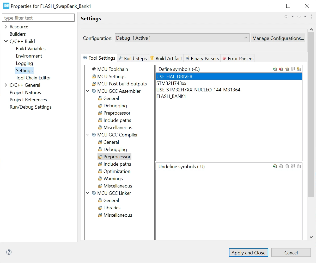

November 24, 2022
Hello @avulas76​ ,
Could you please verify the configuration in your project flash bank 1? and make sure in the other flash Bank 2 there is no FLASH_BANK1
0693W00000WJRKTQA5.pngAlso verify, the vector table in Flash Bank 2 project should map to 0x0810 0000
and check the linker file is correctly set
To give better visibility on the answered topics, please click on "Best answer" on the reply which solved your issue or answered your question.Best regards,FBL
avulas76
avulas76Author
November 28, 2022
Thank you for the information, @F.Belaid​.
I do see the same settings and re-tested the code several times by changing the swapping.
#ifdef FLASH_BANK2 to #ifdef FLASH_BANK1 in main.c file and confirmed the LED functionality working. But the swap functionality NOT works.
Attached are both the BANK1 and BANK2 source codes for your review.

Hello @avulas76​,
1. Compile FLASH_SwapBank2 code with the same flash start address and vector table address than for bank 1 => same .ld file; but generate also a .bin binary file.
2. Load the Bank2 .bin (not .elf) in 0x08100000 using the STM32CubeProgramming - (Bank2 start address)
=> Depending on the value of the SWAP_BANK bit in option bytes, the address 0x08000000 points either to bank 1 or bank 2 and the address 0x08100000 points to the other bank.
- SWAP_BANK = 0:  0x08000000 > Bank 1 0x08100000 > Bank 2
- SWAP_BANK = 1:  0x08100000 > Bank 1 0x08000000 > Bank 2
For STM32H743, it is described in RM0433 Rev 8 Table 19.
