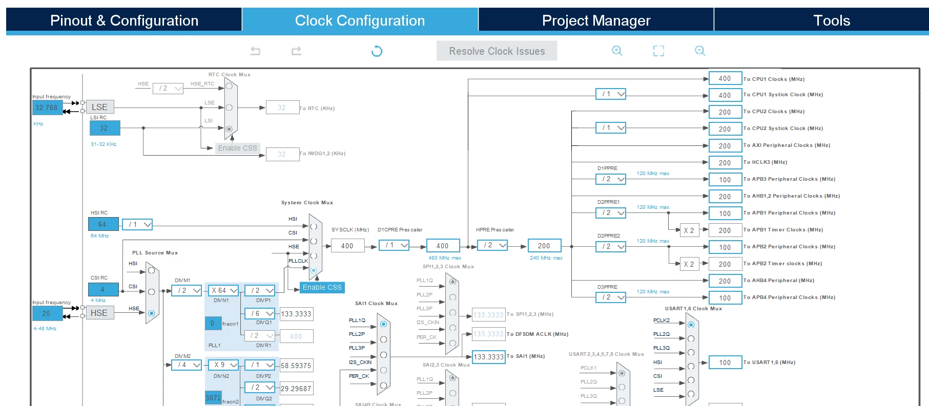

I am working on STM32H757I-EVAL. I am new to STM32 boards. I am using STM32 Cube IDE version 1.18.0. I started with the basic task - blinking led. I have written the code but it is not reflecting on the board.
I have configured this task for four LEDs, I have set PK3, PK4, PK5, PK6 as GPIO Output. In pinout and configuration under system core, I have selected GPIO and configured every pins. Pin context assignment - ARM Cortex M7, GPIO Output level - Low, GPIO mode - output push and pull, GPIO Pull up / pull down - No pull up and no pull down, Max output speed - low.
In RCC mode and configuration, HSE, LSE - Crystal/ ceramic resonator
I have attached image of clock configuration.

I think I have made some mistake here in RCC and clock config, when HSE - bypass clock source, and in clock configuration input freq as 25 MHz. No LED is on for the above code

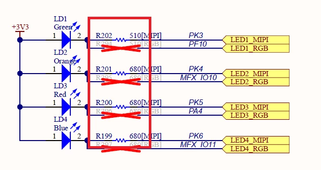

Hi @priya_12,
Can you please tell me which pin is not blinking?
And make sure that R202, R201, R200, and R199 for pins PK3, PK4, PK5, and PK6 are implemented and not removed.
Thank you.

LD3 is not turning on, LD1,LD2,LD4 are on but not blinking.
How do I check if resistors are implemented? It is internally connected already right?

What @ELABI.1 said is to check these resistors as it could someone else unsolder them:
But since all LEDs are on except LD3 you need to check the availability of R200.

At different conditions, 3 out of 4 LEDs are on. Either LD3/LD2 is off. So, I don't think there is any issue with the resistors.
