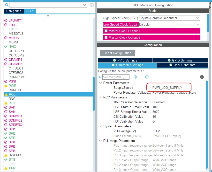

This are two things:
1) You have to correct the connection of VDDSMPS and VFBSMPS.
2) You have to tell the MCU that You want to use the LDO supply by setting PowerSource to PWR_LDO_SUPPLY under RCC ( I know, not very intuitive).

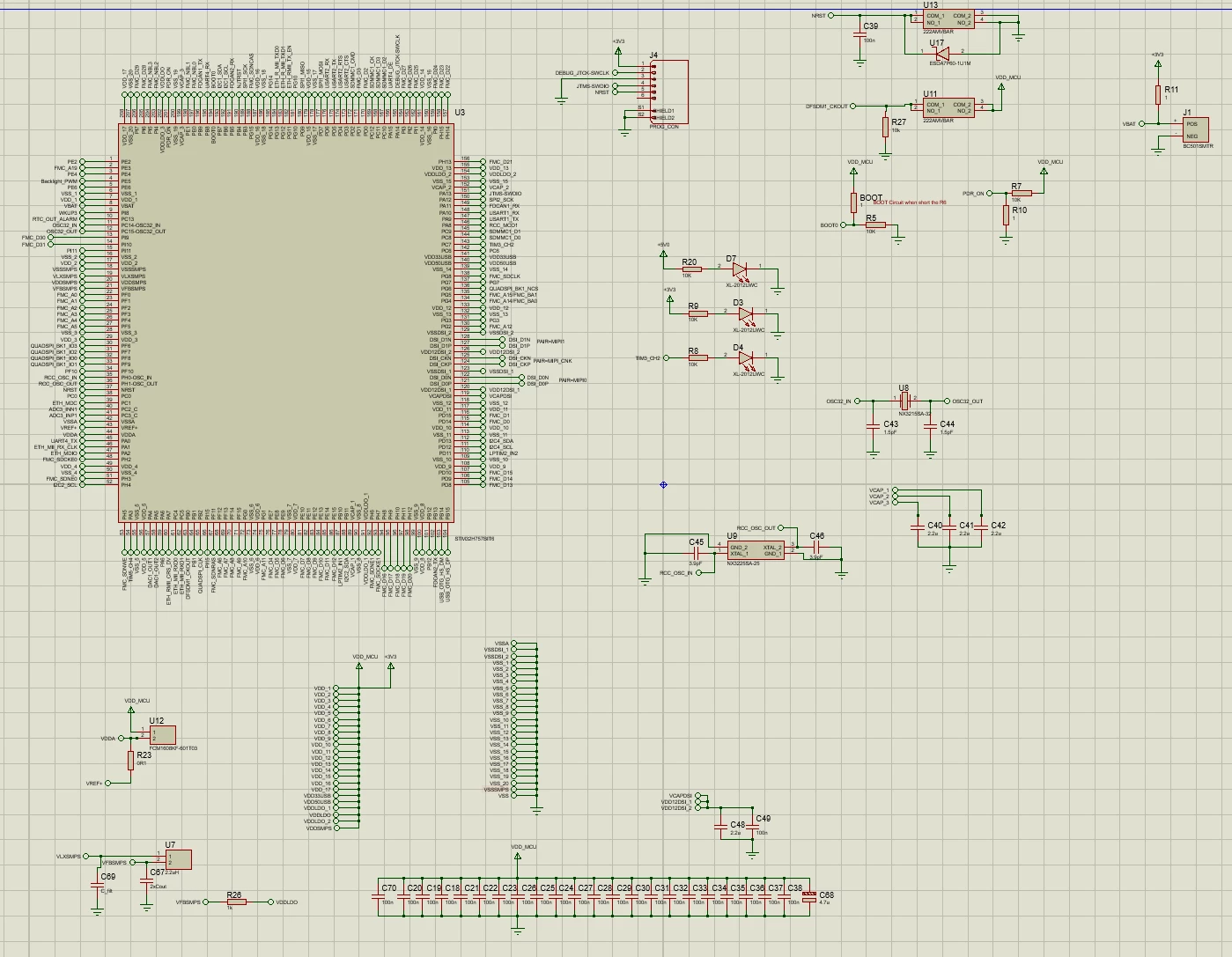

Verify part orientation. Show full schematic.
BerkayCAuthor
Jul 11, 2025 12:19 PM UTC
This is my full schametic of the MCU
mƎALLEm
Jul 11, 2025 1:49 PM UTC
You need to follow the exact hardware schematic I provided for SMPS, otherwise there will be issues in the power.
mƎALLEm
Jul 11, 2025 9:06 AM UTC
Not sure what is the power configuration of the Riverdi board? SMPS?
If so, this is the hardware required for the direct SMPS (RM0399 rev4/Figure 22):
In that case, VDDLDO is connected to VFBSMPS and not to VDD.
So please check all that hardware section.

BerkayCAuthor
Jul 11, 2025 12:00 PM UTC
I connect the VFBSPMS pin to VCap pin and it is programing. The VDDLDO pin is currently connected directly to VDD and can not cut the this connection.
Although the device can still be programmed and enters the while(1) loop during debugging, it consistently draws approximately 27 mA of current. However, the LED does not blink as expected.
BerkayCAuthor
Jul 17, 2025 6:04 AM UTC
This solution is working. I believe the issue was caused by an incorrect configuration in CubeMX, which triggered the MCU to enter protection mode.
