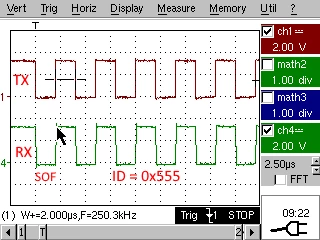

Hello everyone, I am working on our project based on STM32H757I-EVAL board (or NUCLEO-H755ZI-Q). I have already tested several parts that we expect to use Ethernet, UART, I2C, IOs, LCD, LEDs, etc. I have troubles with LwIP TCP/IP stack and finally I use CycloneTCP stack with a success. Last problem is CAN 2.0A communication at FDCAN1.
I was starting with FDCAN_Classic_Frame_Networking example for STM32HT43I-EVAL and adopted to our STM32H757I-EVAL board. The communication works well in a mode set to FDCAN_MODE_EXTERNAL_LOOPBACK and doesn't work in FDCAN_MODE_NORMAL. FDCAN parameters are set for 500 kbps (fdcan_ker_ck to 40 MHz, CPU M7 clock to 400 MHz, AXI and AHB clocks to 200 MHz and finally APB clocks to 100 MHz). The code is same for both modes except one parameter hfdcan.Init.Mode.
  • FDCAN_MODE_EXTERNAL_LOOPBACK works well:

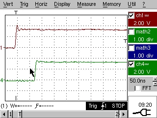

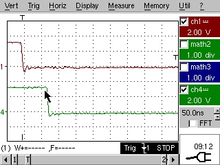

    •    I think TX-RX delay is low about 70 ns (see 01TransitionDelay = 70ns.png and 10TransitionDelay = 70ns.png).

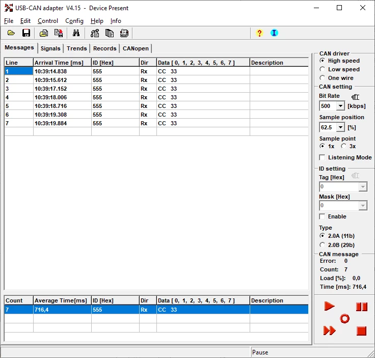

    •    SOF and arbitration with ID 0x555 is OK (see SOF+Arbitration ID=0x555.png) and the bit length 2us is OK.

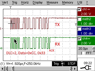

    •    Complete CAN frame sent by CAN unit is OK (see Complete CAN Frame - OK.png) and also last ACK dominant bit sent by USB-CAN adapter is OK.
    •    The frames are acknowledged and logged by USB-CAN adapter (see FDCAN_MODE_EXTERNAL_LOOPBACK Log - OK.png).
    •    There is no error in an SFR FDCAN_PSR.LEC during debugging.
    •    LED2 is toggled after each reception of a valid frame (interrupt, callback and message filters are OK).

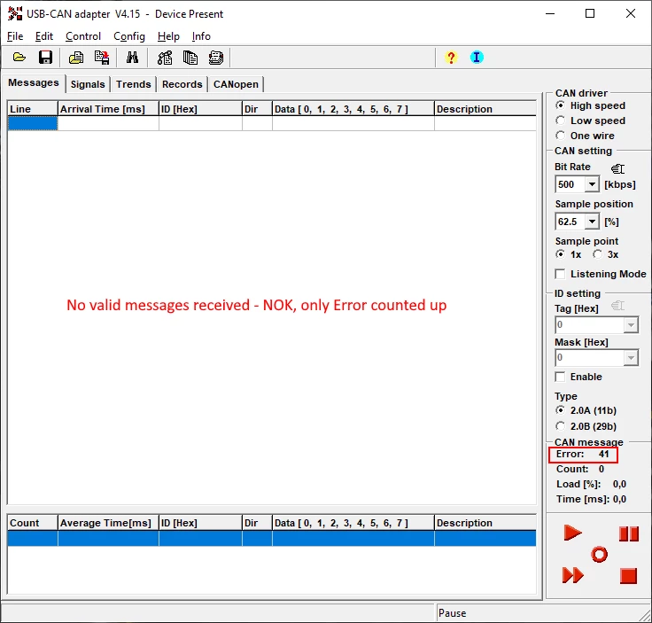

  • FDCAN_MODE_NORMAL doesn't work:

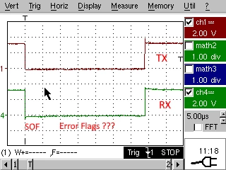

    •    First message sent after reset is SOF and probably signalisation of any error (17 dominant bits, see SOF+Error Flags - First message after reset.png). There is no arbitration, RTR, DLC, data, etc.

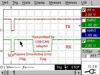

    •    Next messages is SOF and probably Passive Error Flag (6 recessive bits, sent by CAN unit ?) followed by Active Error Flag (6 dominant bits sent by USB-CAN adapter) (see SOF+Error Flags - following messages after first one.png).
    •    USB-CAN adapter doesn't log any valid message, only registered errors (see FDCAN_MODE_NORMAL Log - NOK.png).
    •    There is Error0Bit, 5 (101b) in the SFR FDCAN_PSR.LEC during debugging. Detailed description is at the page 2713 in a ST reference manual RM0399 Rev 3.
I was checking CAN point to point profibus cable, 2x 120 Ohm termination resistors, transceiver MCP2562FD and also verified all relevant parameters with ST documentation (clocks, bit time segments, filters, TX/RX pin settings).

Hello everyone, the problem was solved. There was missing JP2 jumper at STM32H757I-EVAL board for connecting RX signal at CAN transceiver to PA11 pin at MCU. It was my mistake.
Best regards
Capek
