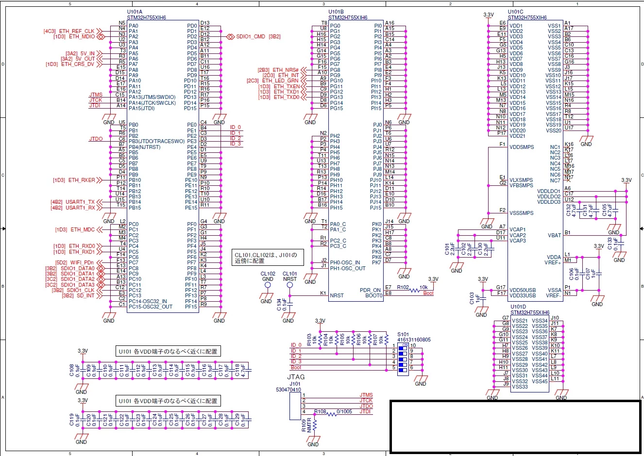

I checked with the Uploaded File schematic board.
I'm using STM32CubeProgrammer.
Connect from PC via UART.
I confirmed that the UART is connected with STM32CubeProgrammer.
​Software has not been written yet.
In that state, the MCU became so hot that I couldn't touch it.
Could you please tell me the possible reasons?

  • Your MCU is broken. Possibly a Latch-up condition.
  • GPIO(s) that are tied to GND are configured as High Outputs.
I hope that helps

Hello,Pedro
When I set Boot 0(E8) to Lo, it no longer heats up.
If I turn on the power before writing software, are there any GPIOs that are output?

Oh my, you connected ALL unused GPIOS to GND?
Bad idea when not knowing there default state after power up.
Check / do the following:
- check your MCU power settings: LDO is on ?
   if you are using HAL, look for something like: HAL_PWREx_ConfigSupply(PWR_LDO_SUPPLY);
- first thing in your code after clock configuration: set all unused GPIOs to input without pull-up and without alternate function

Connecting all unused GPIO pins to GND is based on "AN4899 6.1 Avoid floating unused pins".
If an external PU/PD is required when the power is turned on(Boot0=0), I think you should write that.
When Boot0=1, there is no heat generation, so I think this is correct.
Therefore, I wanted to know which GPIO is changing when Boot0=0.

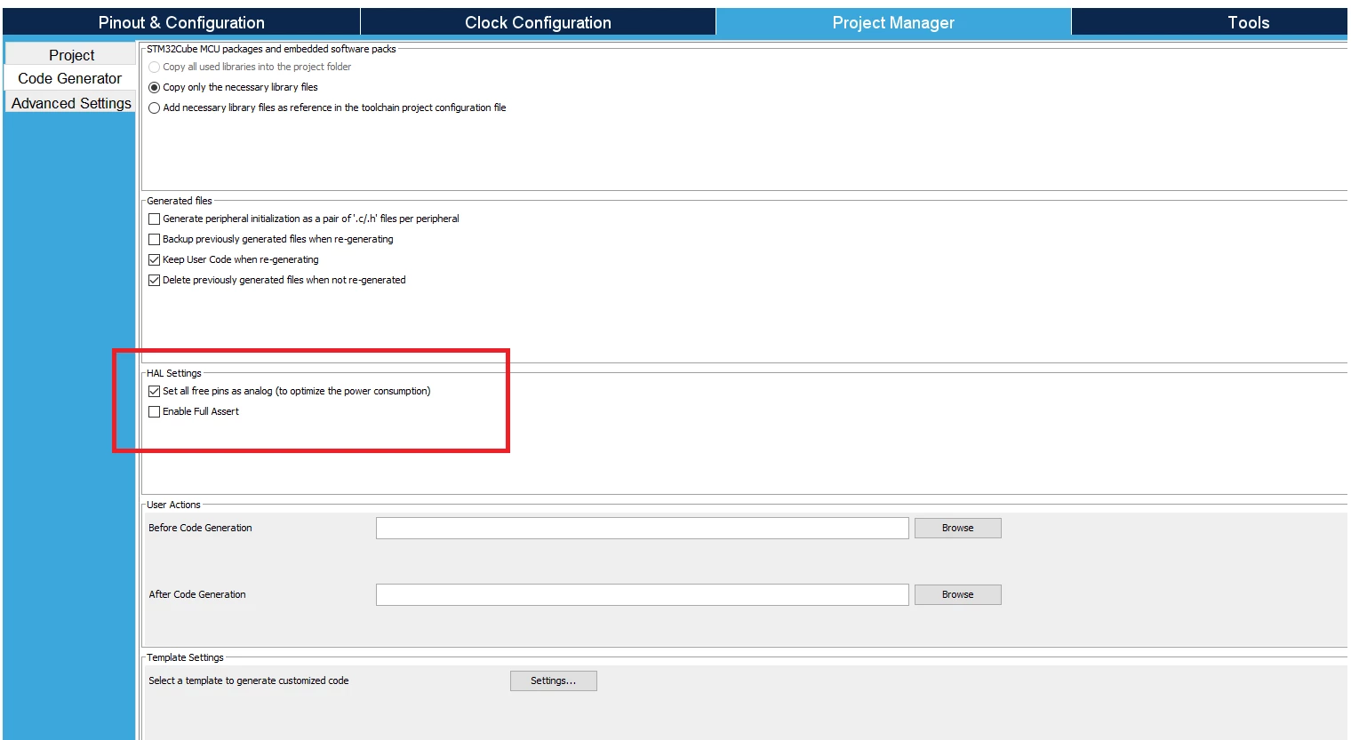

October 31, 2024
reset all unused pins  and select " set all free pins as analog "
