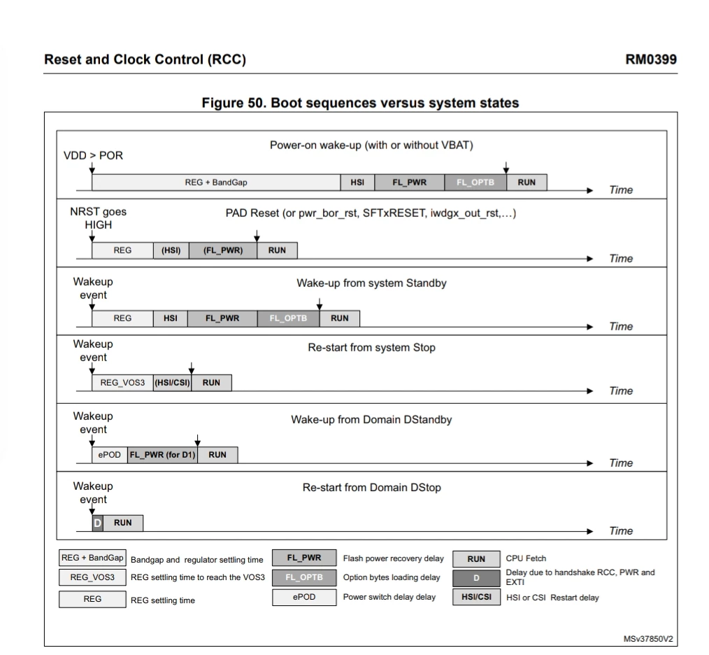

Hello guys,
Can anyone help or provide me the boot sequence diagram of STM32H755xI which has dual-core (M7 and M4)?
Thanks a lot !!!

Hello @NGUYEN-VAN NHI
Are you looking for this diagram:
If not, all available boot diagram you may find on the application note AN2606 or the RM0399.

Dear @STTwo-32
Thanks for your information. It's beneficial for me.
