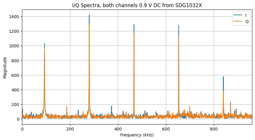

I observe a periodic spur pattern with peaks at:
  • 93.75 kHz
  • 280.31 kHz
  • 466.88 kHz
  • 653.44 kHz
  • 840.00 kHz

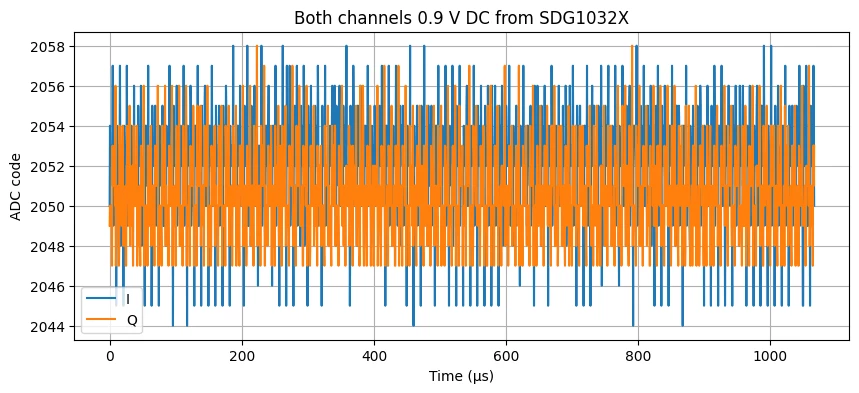

Noise level is below approximately 14 codes p-p when applying a 0.9 V DC input from a signal generator. I am using an external 1.8 V reference.
The spur frequencies shift when I change the sampling rate, but the amplitudes remain more or less the same.

I have a feeling that what you are experiencing is aliasing. That the 50 MHz indeed does disturb the ADC signal. If you change the sampling frequency, the perceived square wave frequency will change as well.
Thought experiment: If the 1.92 MHz sampling rate is correct (Nyquist frequency is then 960 kHz), and the 50 MHz clock is slightly high (just 275 ppm off), then you'll get 50.01375 MHz - (960 kHz × 52) = 93.75 kHz.
If the 50 MHz clock and the sampling frequency are both miraculously spot on, then you would read an 80 kHz square wave on to ADC input. I believe this is too close to be a coincidence.

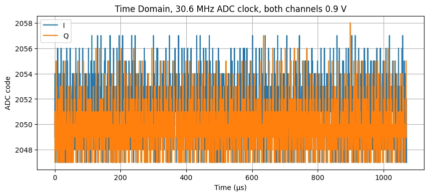

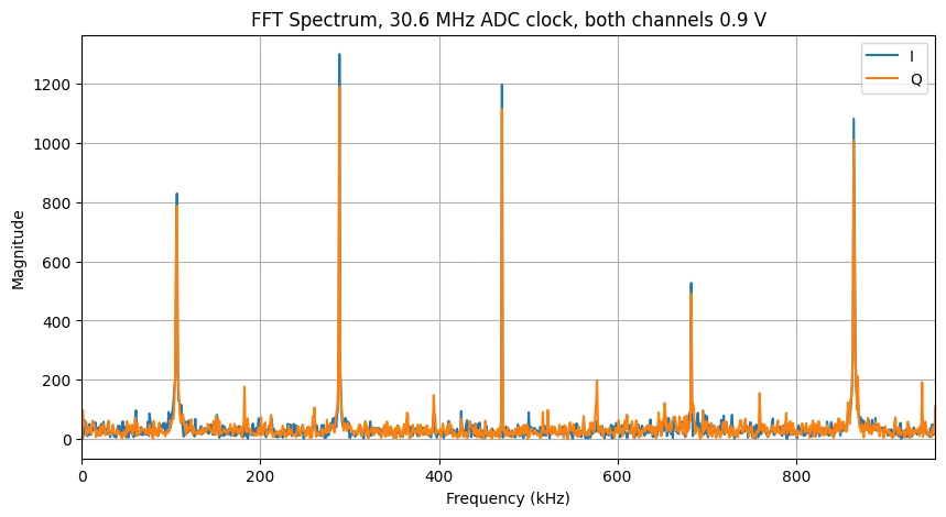

Thank you for the explanation and aliasing formula. I performed another experiment which seems to support your theory.
I changed the ADC clock from 30.719995 MHz to exactly 30.6 MHz by disabling FRACN. Since I am using dual ADC direct mode, the effective sampling rate changed from approximately 1.92 MSPS to 1.9125 MSPS.
With the new sampling rate, the spur frequencies shifted to:
  • 106.46 kHz
  • 288.56 kHz
  • 470.65 kHz
  • 682.64 kHz
  • 864.73 kHz
The spur family still resembles odd harmonics of a square-wave-like disturbance.
The interesting part is that this seems to fit quite well with aliasing from approximately 50.0136 MHz:
  • 50.0136 MHz - 26 × 1.9125 MHz ≈ 288.6 kHz
So your explanation appears plausible.
However, I still have difficulty understanding the actual coupling mechanism. My original assumption was direct PCB coupling from the RMII 50 MHz clock trace, but increasing the ETH_REF_CLK series resistor from 33 Ω to 120 Ω did not significantly reduce the spur amplitude.
Because of that, I am now wondering whether the disturbance could originate from internal coupling inside the STM32H755 itself, for example internal bus/DMA activity.
Has anyone seen similar internally-generated alias/spur behavior on STM32H7 ADCs?
