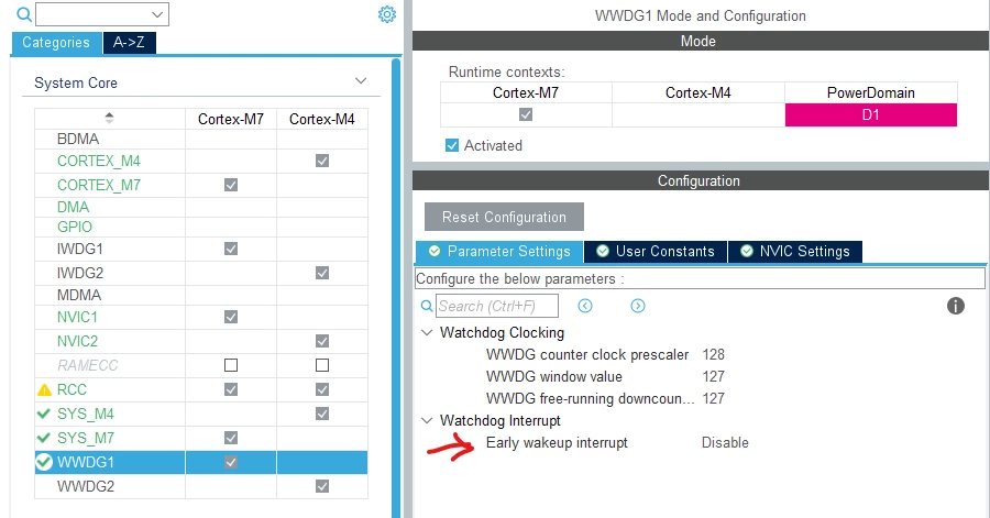

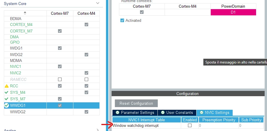

iTTy
iTTyAuthor
May 6, 2025 8:28 AM UTC
@Pavel A. and @AScha.3 , thanks for yours reply.
Regarding the two interrupt:
this one is the "normal" one, which is also reported in the NVIC1 section.
this is the EWI.
@AScha.3 , so these interrupts basically differ for 1 count, right?
But with the NVIC one reset has already been initiated, there are other functional differences?
If I just need to set a variable for WWDG detection (after reset), could I use this one.
AScha.3
May 6, 2025 9:18 AM UTC
Right.  But the early is just an INT , the "normal" is reset/restart.
