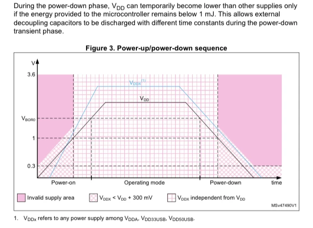

I am designing a board with an STM32H755ZIT6 and want to verify whether my power architecture is safe.
Power architecture:
  • Battery input
  • Two buck converters:
    • 3.3 V buck → MCU VDD
    • 5 V buck → LDO + voltage reference → VDDA and VREF+
Operating case:
For a certain battery voltage range:
  • 3.3 V buck is enabled
  • 5 V buck is disabled
Result:
  • VDD = 3.3 V
  • VDDA and VREF+ = 0 V
Relevant datasheet sections:
  • Power supply management (3.5):
    When VDD > 1 V, all power supplies are independent (except VDDSMPS).
  • Absolute maximum ratings (6.2):
    “All main power (VDD, VDDA, VDD33USB, VDDSMPS, VBAT) pins must always be connected to the external power supply, in the permitted range.”
All conditions appear to be met, but I want to make sure I’m not missing anything, especially since I remember other STM32 families where powering VDD without VDDA is problematic.
Question:
Is it safe and within spec on the STM32H755 to have VDD powered while VDDA/VREF+ are unpowered, assuming no analog peripherals are used?
I would like to confirm this before ordering boards.
Thanks!
TDKBest answer
February 1, 2026
VDD above VDDA is no problem. The reverse is not allowed. You will need to ensure that the same order happens when they are powered down as well. A Schottky diode from VDDA to VDD will ensure this.
From the datasheet, ensure you are never in the solid pink areas.
This applies to STM32H7. Some other families are different.

from H755 ds :
So Vdda can be 0 , if nothing used on analog supply...adc...vrefbuf.
So Vref+ can be same as Vdda , if all 0 V , is ok.
