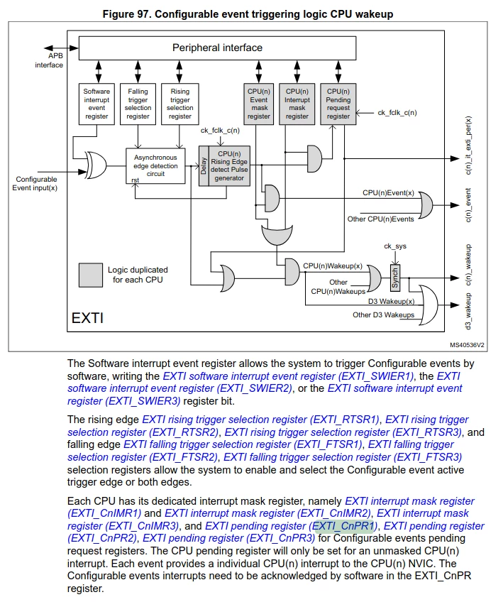

Hello everyone,
I would like to ask if it is possible (and if so, how) to make both m4 and m7 get an interrupt made by the user button in in the nucleo board, since the only Pin Context Assignment options on CubeMX is either m4 or m7. Do I have to do it "manually" by writing the code to register the interrupt on the other mcu?

If you enable the interrupt on the other core using HAL_NVIC_EnableIRQ, you can get interrupts on both cores.
However, it's not a great system. If one core clears the interrupt flag, the other core may not get the interrupt in time. The flag can only be cleared once, so it's hard to process it when both cores are accessing it at the same time. This introduces race conditions. That is the reason STM32CubeMX is not set up to do this.
A better scheme would be to send an event to the other core. Let one core process the interrupt and notify the other core when appropriate. Look at "Event notification" here:

Hello @TDK,
I did some digging, and I found in the RM0399 (page 800) this:
Based on the last paragraph, what i understand is that, each CPU will clear only its own PR, which makes sense by the time that each core has its own NVIC table. I don't think there is actually any race condition. And in my application, both mcus just change "state" and they are not involved by any means. Can you come up with a way that makes the system unsafe? Is there something I don't understand?
Thanks!

Hello guys,
I did in the end use the inter process event communication. Out of curiosity, could someone just check if the above
theory actually works or not?
