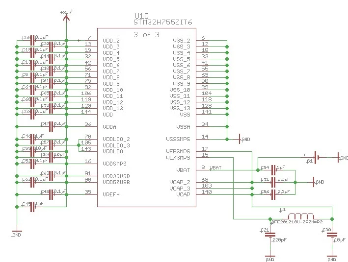

I'm working on project with STM32H755ZIT6. Currently I use Nucleo Board, but I designed prototype board, but the board don't work. I supose that problem is caused by wrong connection for supply.
I use +3.3V from DC/DC connerter for suplly. Can someone help to find out where could be the problem?
Thank you all in advance for any tips.

Because from the beginning you configured the MCU with the wrong power config.
You need to recover your board from that situation and set the correct power supply SMPS or LDO. Read this article:
https://community.st.com/t5/stm32-mcus/how-can-i-recover-my-stm32h7-board-after-facing-a-power/ta-p/49579
For the schematics, I invite you again to look at the schematics of NUCLEO-H753ZI for LDO: https://www.st.com/resource/en/schematic_pack/mb1364-h753zi-c01_schematic.pdf
and NUCLEO-H753ZI for SMPS: https://www.st.com/resource/en/schematic_pack/mb1363-h755ziq-d01_schematic.pdf

Need to check first your power supply config in the application versus what do you have on the HW.

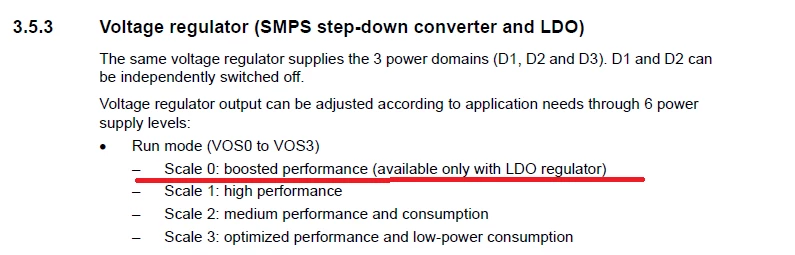

void SystemClock_Config (void)
 /** Supply configuration update enable
 HAL_PWREx_ConfigSupply(PWR_DIRECT_SMPS_SUPPLY);
 __HAL_PWR_VOLTAGESCALING_CONFIG(PWR_REGULATOR_VOLTAGE_SCALE0);
 while(!__HAL_PWR_GET_FLAG(PWR_FLAG_VOSRDY)) {}

From your side please review your schematics and check if there is somethong wrong with SMPS HW by comparing it to NUCLEO-H755ZI schematics: https://www.st.com/resource/en/schematic_pack/mb1363-h755ziq-d01_schematic.pdf
And according to your code you are setting the SMPS and this configuration you cannot exceed 400MHz at VOS1.
From the datasheet:

For internal SMPS, the capacitors on VCAP should be pair of 100nF not 2u2F ?
