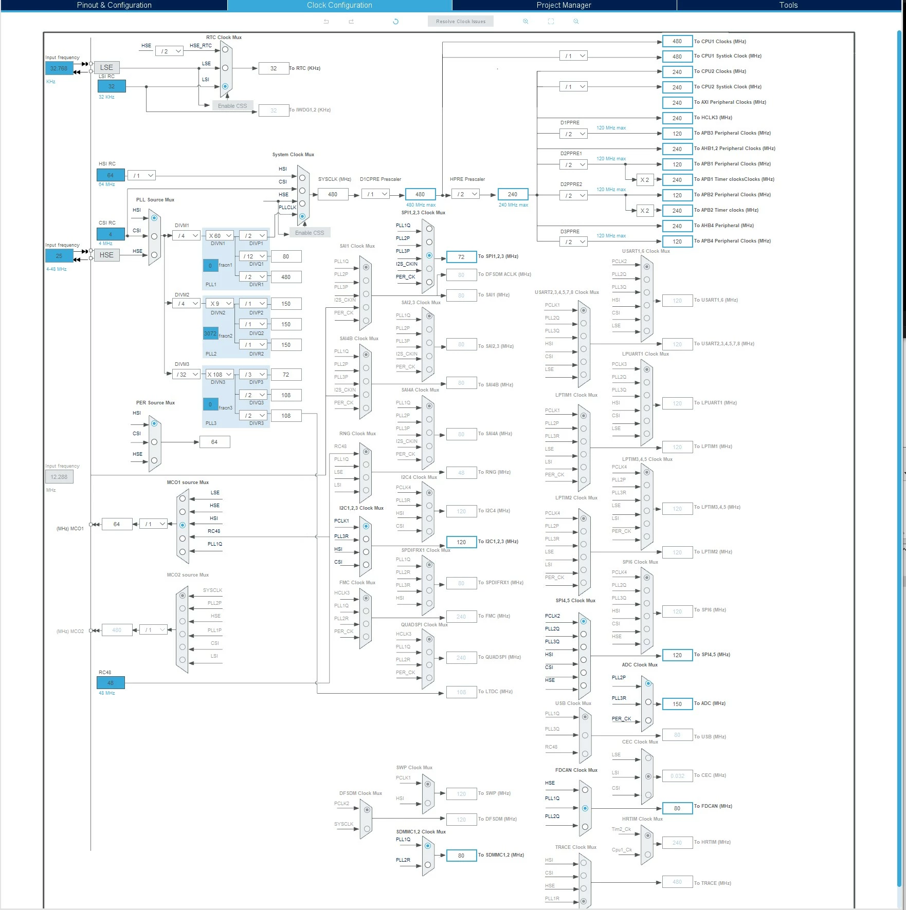

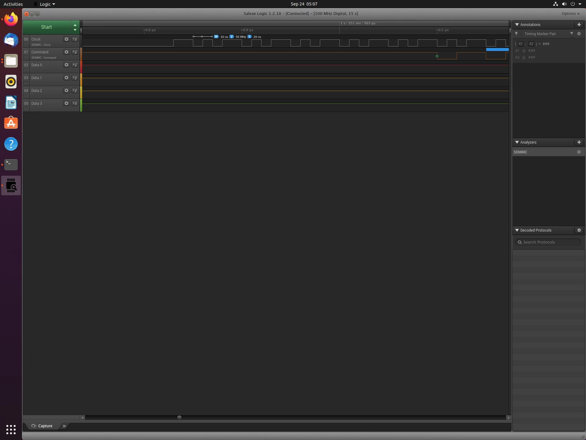

I'm attaching a picture of my clock configuration and Logic Analyzer (Saleae Logic Pro 8) so it is easier to see what I'm doing.
I have set the SDMMC clock divide factor to 1 in the configuration tab, which should produce a divide factor of 2 in the end. This would result in 40MHz clock signal.
Now comes the issue, as you can see from the other two screenshots, the clock signal changes between 33MHz and 50 MHz, of which neither are expected.
Any ideas how should I start to debug this?
My clock configuration code (auto generated):

I have a bunch of other peripherals connected, as you can see, but I have not paid attention to them too much at this point. I have tested the FDCAN connections that they are working as expected and I'm able to control the device connected to the I2C.
Since I am new to the world of SDMMC, am I right that this should not be the clock signal wave form?
My setup otherwise:
  • This is a custom PCB with STM32H755
  • I'm using a 4-bit wide, 32GB eMMC from ISSI
  • The waveform is from the MX_SDMMC1_MMC_Init()
    • I have no other actions in the code for using the eMMC at the moment
    • The configuration phase clock seems to be pretty close to 400kHz, I see it changing between 398kHz and 400kHz
  • I'm using FreeRTOS, but during this stage, the scheduler is still off
  • I have not configured the MPU at all, but I and D cache are enabled currently.
I'm also attaching my linker file if it should be of value.
Any help will be appreciated.
Best regards,
Tero

Increase your logic analyzer sample rate. You're just seeing quantization error.
TOlli
TOlliAuthor
Senior
September 25, 2020
Hi TDK,
I upped the sampling rate to 500 MHz, but I'm still seeing oscillation in the frequency. Now it is swapping between 41.67 MHz and 35.71 MHz .
It should not be doing that anymore, should it?
September 25, 2020
My guess is you're at 250MHz sampling rate. 1/(41.67MHz) = 24ns. 1/(35.71 MHz)=28ns. If you sample every 4ns, this is exactly the behavior you would expect. Even at 500MHz, it's still going to oscillate between values. Don't expect infinite precision here. I don't think there's an option to sample at a multiple of 40MHz.
