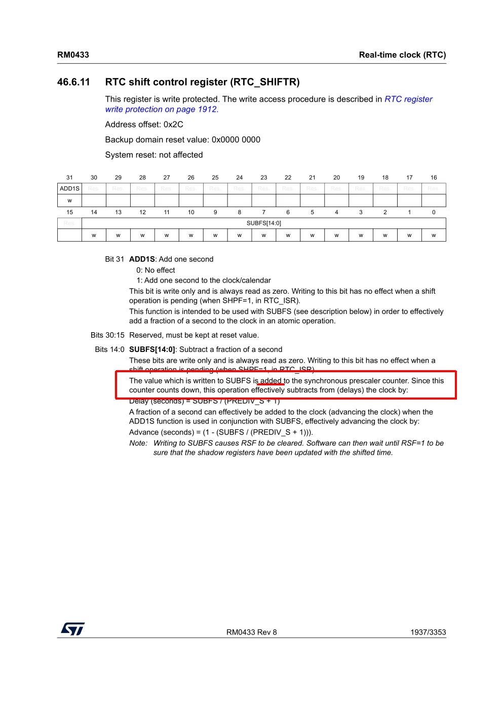

> I expect that it should be lower than 100 but close (not higher)
Why would you expect that?
Note, that as consequence of shift, SSR can even get higher than the synchronous prescaler - description of SSR register warns for that.

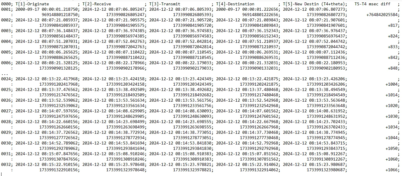

I just tried to setup RTC time and msec only one-time after initialization (after first SNTP packet received) and then I only calculate differences (so without calling SET RTC time and HAL_RTCEx_SetSynchroShift )
I am attaching log of timestamps, offsets, etc... from both LSE and HSE, it is abou 15 seconds periodic
In LSE if I disable periodic synchronization, you can see cumulative difference (last column), and here if I turn periodic sync + shift it works ok.
But for HSE version, it look like that values are in waves, or saw... hard to say
Radim

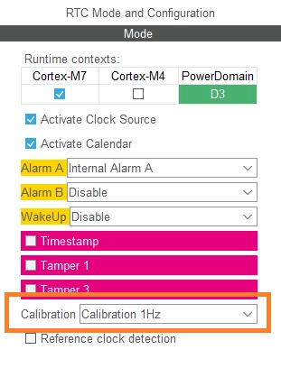

Dec 10, 2024 3:45 PM UTC

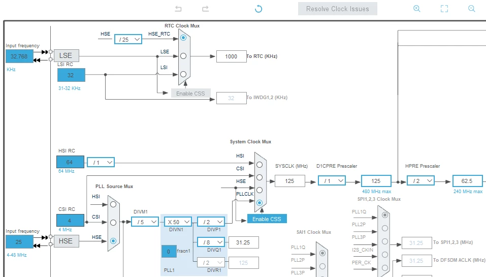

I suppose that it is running from 25 MHz :) I verified the HSE clock by scope using MCO output and is working fine.
I am using NUCLEO H755 board https://www.st.com/en/evaluation-tools/nucleo-h755zi-q.html
I solder xtal, capacitors and change SBxx resistors to adapt HSE instead of default clock 8MHz - STLK_MCO from STLINK. All periferials working normally, and ALARM on RTC produce 1sec interrupts. I am attaching both IOC files, and screenshot for quick verify
Radim

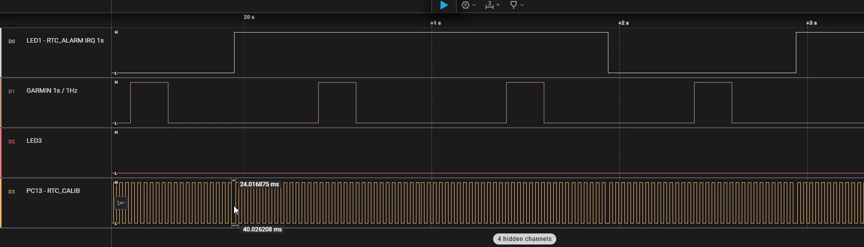

Thanks for your comments. Do you think that this is not related to fact, that I don't have PREDIV_S non-zero multiple of 256 as noted in 49.3.16 Calibration clock output in TRM document:
"When COSEL is set and “PREDIV_S+1” is a non-zero multiple of 256 (i.e: PREDIV_S[7:0] =
0xFF), the RTC_CALIB frequency is fRTCCLK/(256 * (PREDIV_A+1)). This corresponds to a
calibration output at 1 Hz for prescaler default values (PREDIV_A = Ox7F, PREDIV_S =
0xFF), with an RTCCLK frequency at 32.768 kHz."
But I have here 30 pulses in 1 seconds with period * 32 ms + (at end one which is 16 ms positive pulse + 24 ms pause ) which correspond to TRM.
But I don't know if this could also affect SHIFTR. What do you think ?
Regards Radim
waclawek.jan
Dec 10, 2024 6:30 PM UTC
At this point, I'm confused what are you actually doing.
I thought you are reading out time including SSR to compare to SNTP timestamps; but now you brought out RTC_CALIB output. So which one is it?
The calibration output is probably an extra issue in itself.
ravoAuthor
Dec 10, 2024 6:58 PM UTC
Please apologise me, maybe I'm mixing two things together which are not related. I just remember one my older issue with calibration output, when I start playing with RTC clock on STM32. When in MX Cube select calibration output 1Hz and then observe that there is no 1Hz. But It depends on correct value of async and sync prescallers.  as noted in TRM manual. But now I don't play with calibration...

How do you read out the current time from RTC and convert it to milliseconds, exactly? What are the bus clocks frequencies in relationship to RTC clock frequency?
Could you try to use a higher divider (e.g. 50) to make sure the RTC clock is below 1MHz?

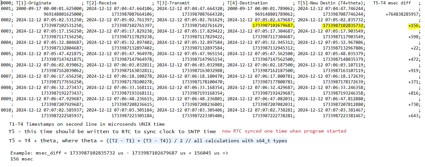

>>> RTC is not set from NTP time (except for the first time), correct?
Yeas exactly I do this way... but logs look quite different that for LSE (there was cumulative msec_diff)

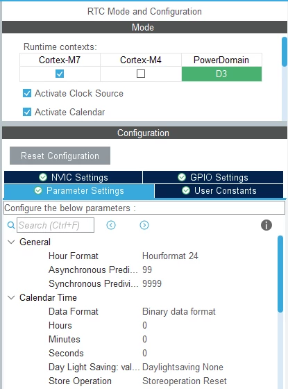

So I tried to change 25 -> 50 divider PeriphClkInitStruct.RTCClockSelection = RCC_RTCCLKSOURCE_HSE_DIV50;
So now RTC clock input should be lowered to 500 kHz and with ASYNC = 49 and SYNC = 9999 prescallers I still get msec_diff 156; 598; 22; 472; 919; 371; 816; 730; 643; ... so it did not still helped:
Update: For comparsion when RTC is working from LSE with same prerequisites (only one time set RTC without SHIFTR correction) so first diff is 817msec. And in this option it works as expected.
