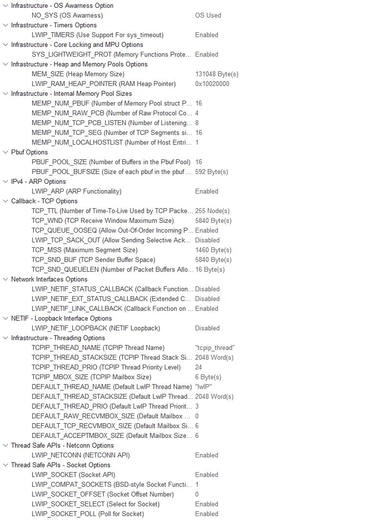

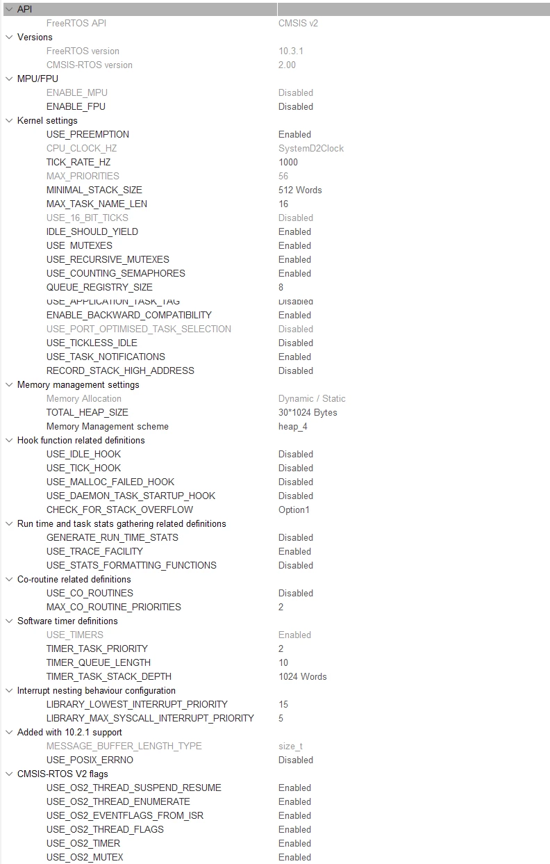

I have already implemented the vApplicationStackOverflowHook. In the attached video you can see the implemented function vApplicationStackOverflowHook() and how the program ends there.

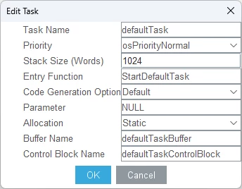

I also monitored the stack size of each task with STM32CubeMonitor with the function https://www.freertos.org/uxTaskGetStackHighWaterMark.html. The stack size is for each task always the same size.
I have also added the configuration.
Maybe someone here can see at first glance what was configured incorrectly.
FreeRTOS M4 Configuration
LWIP Configuration
