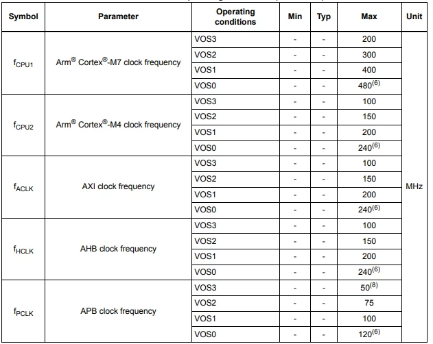

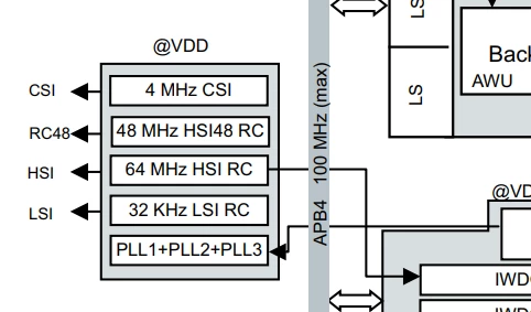

Hello everyone, I'm working on an STM32H755BI (industrial temperature range), and i'm quite disappointed by the maximum clock reachable from the system.
As can be seen, the MCU can reach up to 480MHz in the core M7 and 240MHz in the core M4.
After months of develpment, a firmware package update blocked me the VOS0 and VOS1, and in fact reading the user manual those modes are unavailable on my package, so i reduced to 300MHz and 150MHz

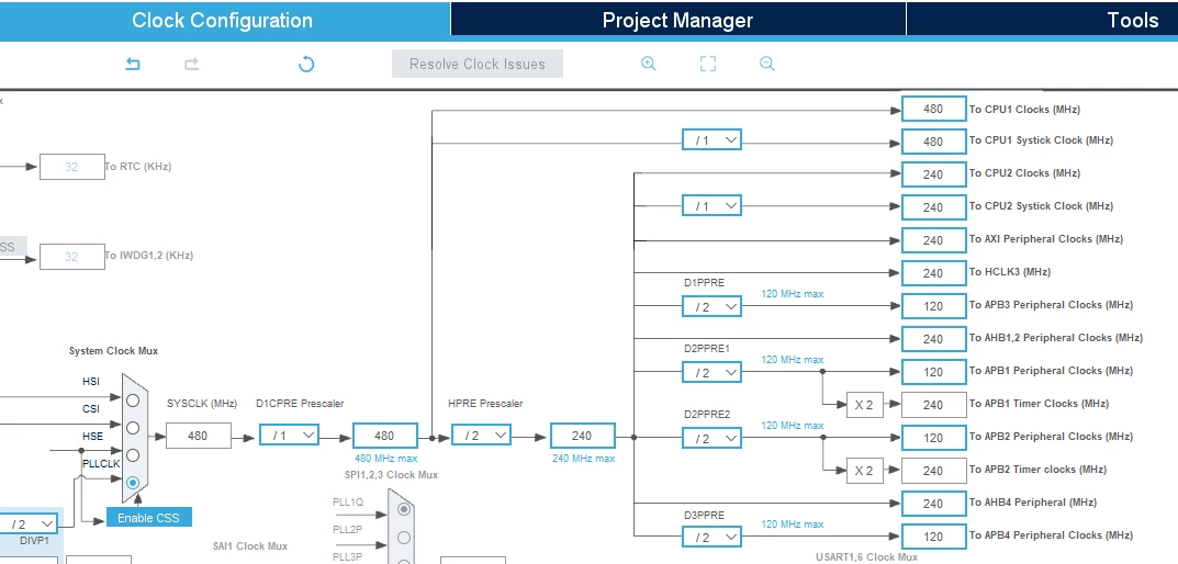

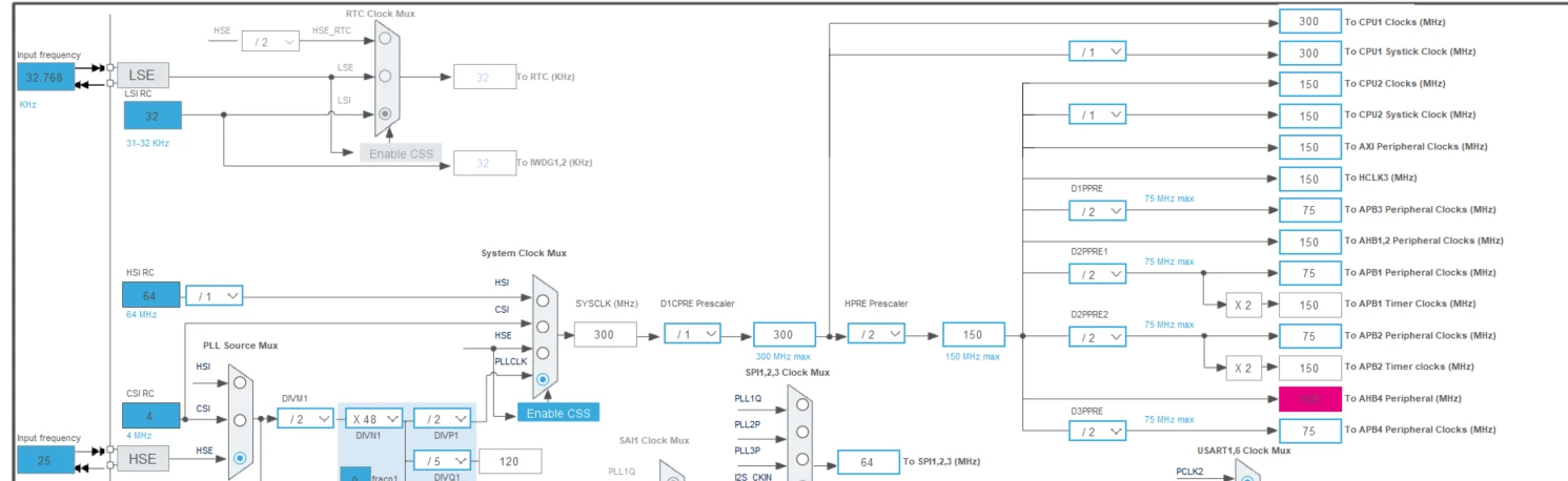

Today, with an update of cube MX, this error appeared in the clock tree:
And in fact by reading the datasheet APB4 is limited to 100MHz.
Reducing APB4 to 100MHZ could not be a big deal, but the real problem is that considering the clock distribution in the previous image the clock of the APB4 is the same clock of the M4 (CPU2).
Does this means that i bought a 480+240MHz and i'm forced to use it at 300+100 after more than a year of development?

It has a direct link on the maximum Frequency of the CPU and on the VOSx depending on the temperature.  In order to understand correctly your application use case, do you know what is the expected operating temperature ? For instance to reach 450MHz for M7 , VOS0 is a must , however limited to junction temperature up to 105 degrees Celsius.
February 13, 2024
Interesting.
The reference manual says it can do 480 MHz. It would be odd for the datasheet to have such a large error. The H745/H755 has been out for a while and is clearly advertised as 480 MHz capable. I would be surprised if it were only capable of 300 MHz.
The CubeMX folks tend to follow the datasheet, so it's not surprising that CubeMX flags the error.
The restriction seems to only be listed in that one figure. In many other places in the manual, it says CPU2 can run at 240 MHz, so that's not very consistent.
On the other hand, there is this note in the datasheet which suggests the change was intentional:
Nothing relevant in errata sheet.
Perhaps @STOne-32 can look a little more closely at this.

Not sure the plumbing is consistent with how it used to be.
APB4 used to be fractional from the AHB clock (M4 CPU), so M7 400 MHz, AHB 200 MHz, APB4 100 MHz.
Should be possible to get 150 MHz M4, with 75 MHz APB4 using the same relationships.
I suspect the paper relates to electromigration exacerbated by speed and temperature.
As I recollect the early H7's could hit >500 MHz in nominal conditions, vs 400 MHz spec, later revised upward to the 480 MHz on the V-Step

@TDK Thank you for the reply. The maximum clock was reduced to 300MHz with the FW package 1.11.0 if i'm not wrong. But the datasheet confirms this maximum value of 300MHz and there is nothing to do. The reliability is a crucial requirements so i have to follow the requirements.
I also think that your pointed note refers to VOS3 (or at least i hope, since FCPU2 of 150MHz is allowed by cube)
@STOne-32 My problem is not the reduction from 480 to 300 MHz due to the VOSx settings, but the new limit in the APHB that blocks the CPU2 from reaching frequencies allowed by the current VOSx settings, limiting it from a theoretical 240Hz to a maximum of 100MHz.
That would be my read of it too.
I suspect CubeMX is applying VOS3 rules, not VOS2 rules. The gearing would look to permit 300+150 or 200+200

APB4 != AHB4
The M4 MCU runs at AHB4, the peripheral bus runs from APB4 at 100 MHz or below
halbeeee
halbeeeeAuthor
February 13, 2024
Yes you are right, I confused AHB4 and APB4 but this not change the fact that CubeMX don't allow me to apply 150MHz, which now is also a value that can be used according to the datasheet.
Is a kind of bug? Or a limit?
Tesla DeLorean
Guru
February 13, 2024
Me thinks it's a bug..
But I don't use CubeMX to build my clock trees.
The limits on the M4 are going to be critical path related in this context, running the transistors at 300 MHz isn't going make them run any hotter on the M7 vs M4 side of the die.
I've got Cortex-M3's running at 384 MHz on other processes, admittedly I don't have the FPU-S to contend with, but still.
Honestly I'd like to see a lot better analysis of where ALL these limitations are coming from. And what critical paths have been identified.
For example are there good reasons why 300+300, 250+250 or 240+240, etc aren't actually workable?

@Tesla DeLorean You are likely correct that the figure is from before the max frequency was bumped from 400 MHz to 480 MHz. Figure would be consistent with 400 MHz. Good catch on APB vs AHB, I should have caught that.
All that acknowledged, the underlying question remains the same. Datasheet clearly indicates 480/240 is possible on that chip, yet CubeMX doesn't allow it.

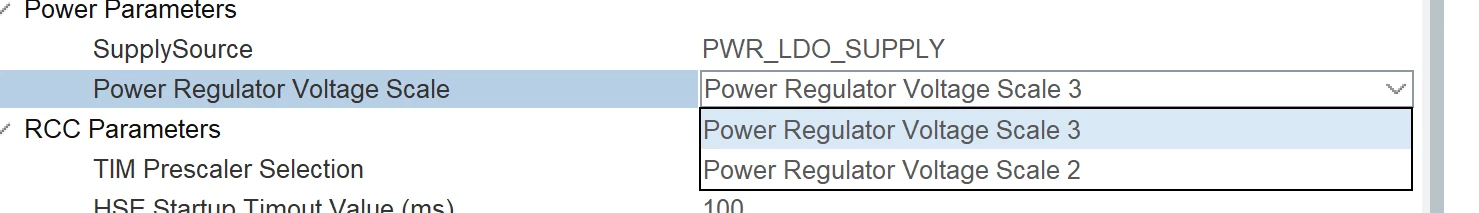

Underlying problem seems to be CubeMX doesn't allow VOS0 or VOS1 to be selected on STM32H755. Unclear why, probably a bug, but I could be missing something. They simply don't appear as options. No such issues on STM32H745.

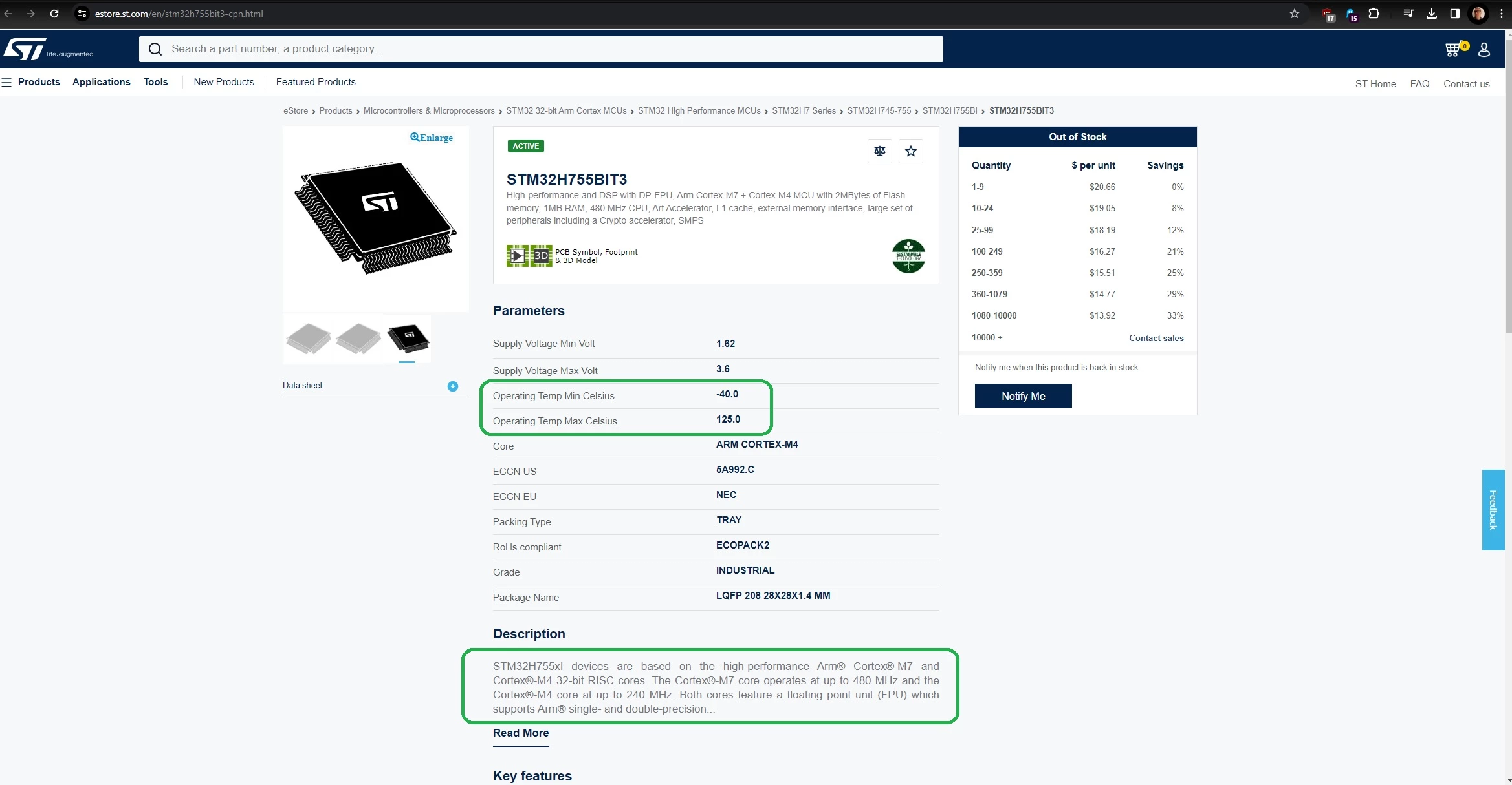

The basic "problem" is the allowed temperature range : -3  vs -6 , 125° vs 85° .
When 85° , 480/240MHz max., but at 125° 300/100MHz .
see
https://estore.st.com/en/stm32h755bit3-cpn.html
https://estore.st.com/en/stm32h755bit6-cpn.html
but wrong "promises" : > M7 core operates at up to 480 MHz ..< --- only for -T6 true !!!
And with -T3 only VOS2 or 3 allowed...
