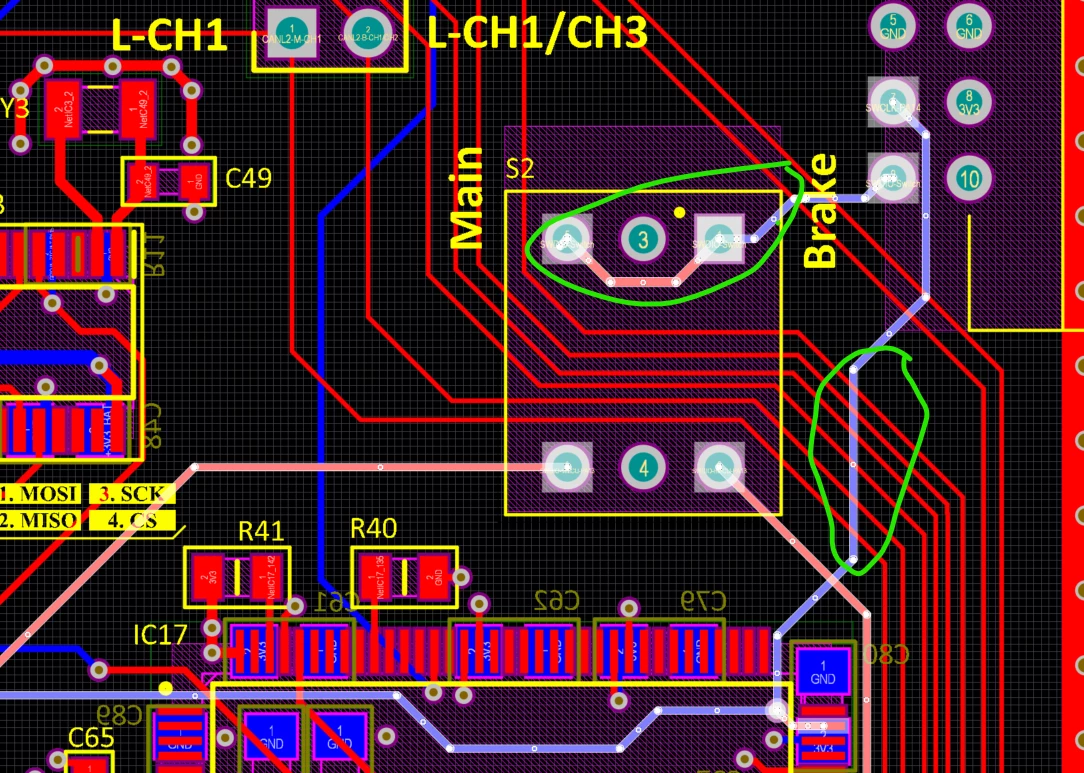

Hi
I am developing a board with two MCU on it (stm32h755), and I am going to programme these two controllers from the same connector using only two lines (SWDIO SWCLK), I have connected same CLOCK line to both MCUs directly, and the SWDIO to a switch to select which MCU to programme, is this connection fine??
Also this MCU has the CANFD, but I want to use normal CAN, is it fine to connect it to a normal CAN transceiver not CANFD one??.
thanks

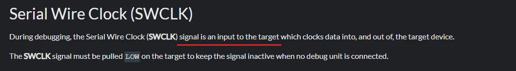

SWCLK is an input to the MCU so you can share it with both MCUs: https://developer.arm.com/documentation/100893/1-0/Debug-and-trace-interface/Serial-Wire-Debug-signals

Dec 3, 2024 4:08 PM UTC
Hi Soflit.
to make it clear on the first question, I want to prgramme each MCU alone using STlinkv2, but both MCUs are sharing the clock line only and the data line is go to a switch to determine wich MCU to be connected with the STlinkv2.
and thanks you answered the second question I don't want to exceed 1Mb/s
mƎALLEm
mƎALLEmBest answer
Dec 3, 2024 4:16 PM UTC
