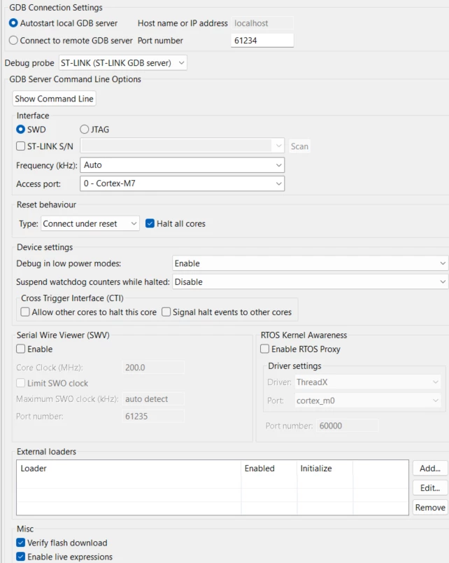

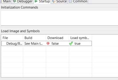

CM7 like this:

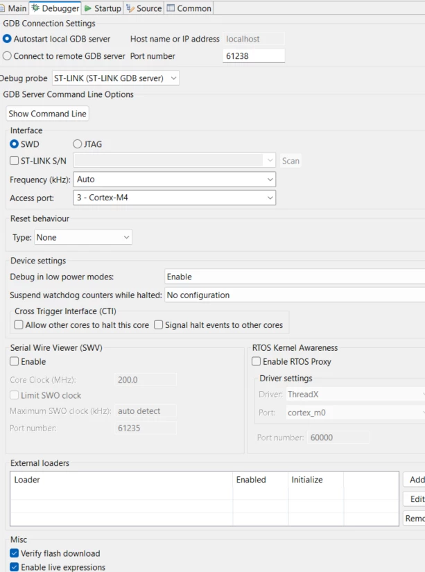

CM4:

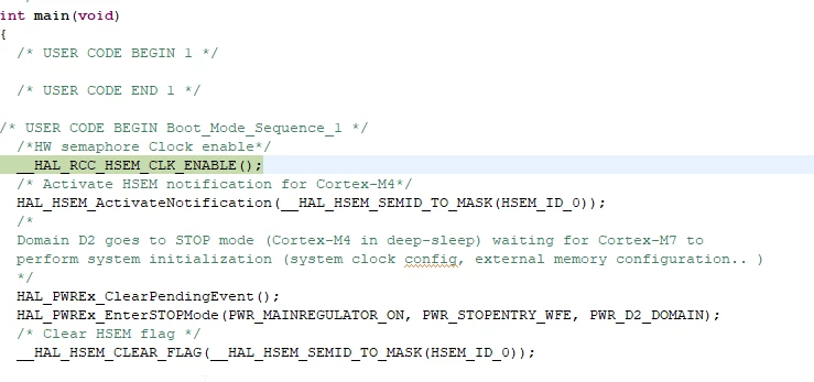

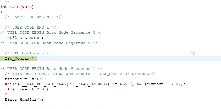

With that configuration when I launch CM7 first, then CM4, both pause as expected with CM4 in reset and CM7 ready to go. When I select both cores then click on the green go arrow, CM7 runs straight into this:

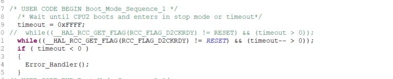

Caused by the timeout expiring.

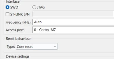

If, alternatively, I configure CM7 like this:
Then I can debug both cores, but they aren't doing a coordinated start as they should.
I know that I could ignore the timeout error, but then the systems wouldn't be doing a coordinated start as they should.

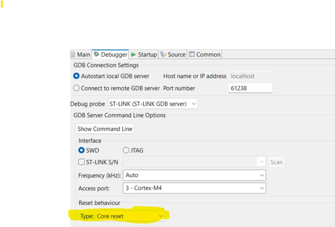

However, I have found that if I set the CM4 in the mode shown below then I can proceed without having to disable the CM7 timeout check:
I'm OK with this, since I have a solution that works.
Thanks again for your help.

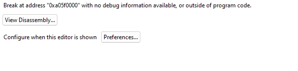

2. Start the M4 debug => Hot attach to the M4 which is halted at the beginning of its main function.
3. Start the M4 => it goes in stop mode
Here you get a dummy screen => don't give attention to the address given, just keep in mind that the M4 core in in stop mode.
4. Now you can start the M7. It will execute the HAL init and the config clock and continue running or stop on the next breakpoint.
5. Resume the M4.
At this stage, both cores are running.
