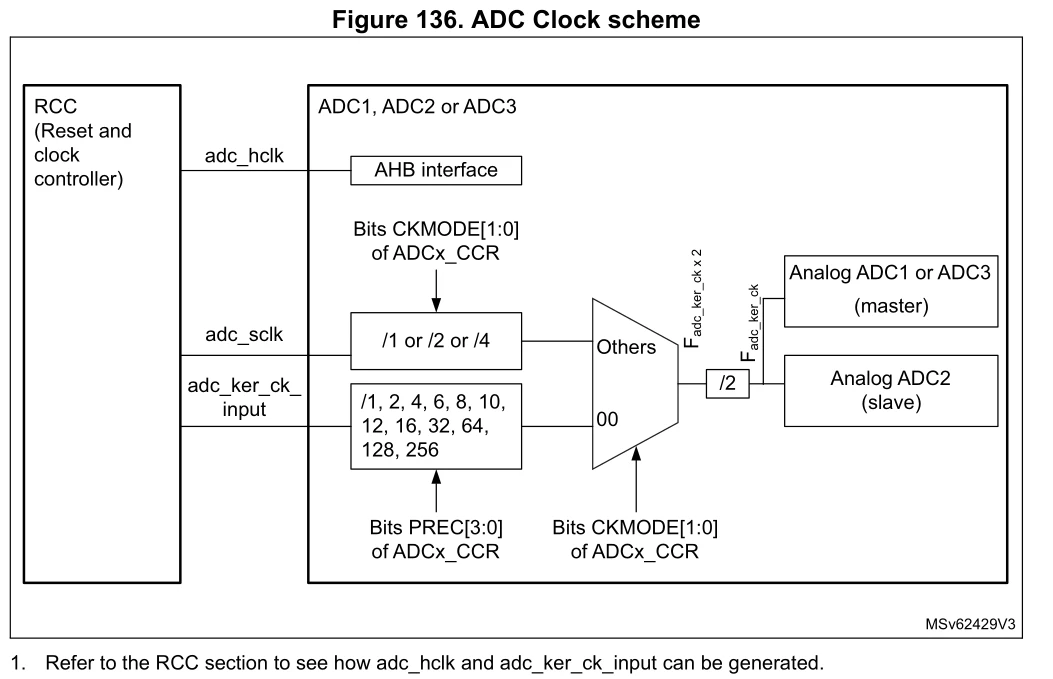

I'm using STM32H755 nucleo board and evaluating ADC. I'm using ADC1 and ADC2. I like to get 1.92MSPS per ADC (12bit). According to my understanding I need minimum 8 cycles for conversion and therefor I was using 15.36MHz clock rate. With these settings, I'm getting 960kSPS rate, which is half what I expected. Then I doubled clock rate to 30.72MHz, which gives correct 1.92MSPS per ADC. According to AN5354, maximum ADC frequency is 17MHz (LQFP144), which is much lower than my current setting. Can I use 30.72MHz clock for ADC and why it has to be double?

Hello @mosamasa
Regarding the sampling rate, the ADC needs a minimum of 2.5 ADC clock cycles for the sample period and 12.5 ADC clock cycles for conversion (12-bit resolution), resulting in a total of 15 ADC clock cycles. This aligns with your observation that doubling the clock rate to 30.72 MHz achieves the desired 1.92 MSPS per ADC.

My understanding is that I need 6.5 ADC_CLKs + 1.5 => 8 ADC_CLKs according to STM32H7 - ADC presentation.

I'm currently using software to trigger ADC. I was trying to use TIM2, but for some reason I was not able to find settings, which are working.

Get RM0399, I think there is a divider /2 in the ADC clock interface, same as on H743 /753 adc  version V.
