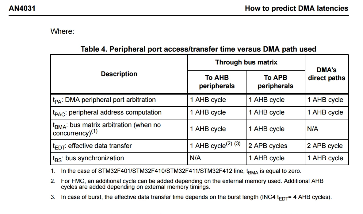

However, AN4031 mentions that the peripheral port access/transfer time is at least 4 AHB cycles (which would be 500 ns here). Why is the observed hold time shorter? My guesses are:
  • The non-incrementing peripheral address causes the peripheral address computation phase (t_PAC) to be simplified or omitted;
  • During continuous burst transfers, the peripheral port arbitration (t_PA) is not performed again;
  • Or the DMA latches the peripheral data before the bus matrix arbitration (t_BMA).
Are these guesses valid? Or is the timing of the H7 series DMA fundamentally different from what is described in AN4031? I look forward to your reply. Thank you!

It is true that, for both STM32F4 and STM32H7, the DMA is on the AHB bus matrix.
However, there are other architectural differences between STM32H7 and STM32F4:
  • On STM32H7, GPIO is located on AHB4, which belongs to the D3 bus matrix.
  • This is not the same matrix as D2, where DMA1 and DMA2 are located.
Referring to the transfer timing presented in AN4031, Table 4:
  • For STM32F4 devices, tBMA bus matrix arbitration is always counted, except for the STM32F4 devices mentioned in note 1.
  • For STM32H7 devices, tBMA bus matrix arbitration is counted only on the first data transfer.
Thank you.

Regarding the “4 AHB” I mentioned, let me clarify: I did not mean that AN4031 explicitly states a “4 AHB request time”. My basis is Table 4, column “Through bus matrix / To AHB peripherals”, in non-burst mode, where the phases add up as follows:
  • t_PA = 1 AHB
  • t_PAC = 1 AHB
  • t_BMA = 1 AHB
  • t_EDT = 1 AHB
  • t_BS = N/A
This gives a total of 4 AHB cycles.
Please note that Note 3 applies only to the t_EDT cell, not to the entire table. It says that in burst mode t_EDT depends on the burst length, for example INC4 gives t_EDT = 4 AHB cycles. My configuration does not enable the FIFO and does not use burst, so Note 3 does not apply, and t_EDT is taken as the default 1 AHB cycle.
I also understand that AN4031 is for STM32F2/F4/F7 DMA. My device is STM32H755: DMA1 is an AHB1 master in the D2 domain, while GPIOA is an AHB4 slave in the D3 domain, so there is a cross-domain access. Therefore AN4031 Table 4 cannot be directly applied to H755. I cited it only to explain where my initial “4 AHB” statement came from. My measured 2 AHB cycles also indicate that the H755 behavior differs from the F4 model.
