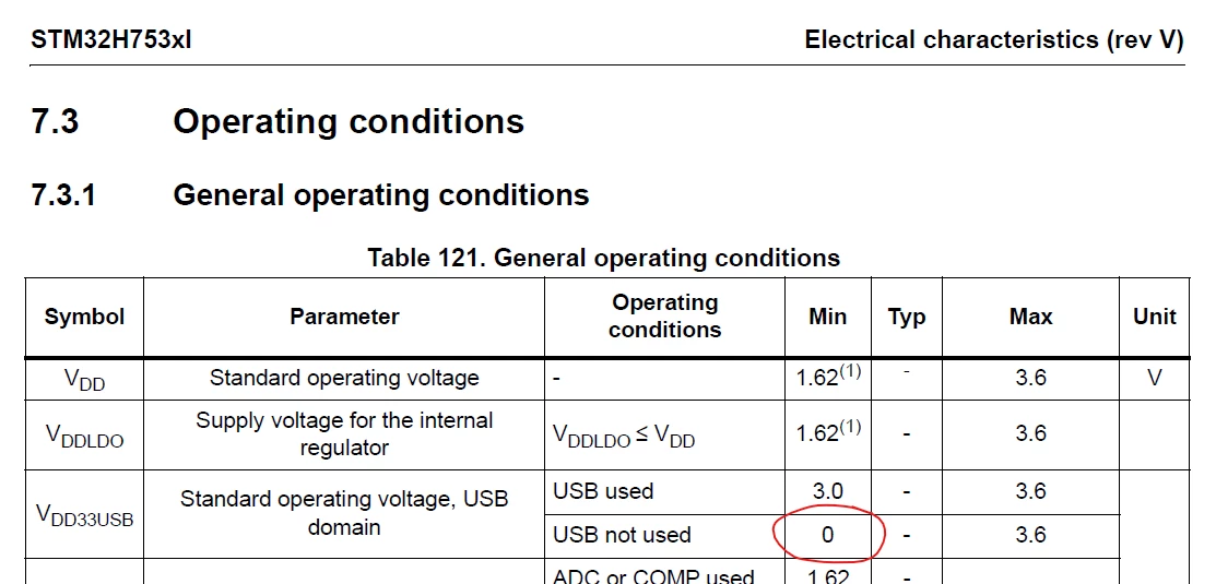

STM32H753ZIT6 - Power supply connection when not using USB
Hope this is a simple question.
I use this device: STM32H753ZIT6
I don't intend to use USB so looked in the datasheet and found the below
Does that mean I can safely connect VDD33USB to GND?
Thank you.

Correct.
Regards
/Peter

Great thank you, for a prompt answer.
