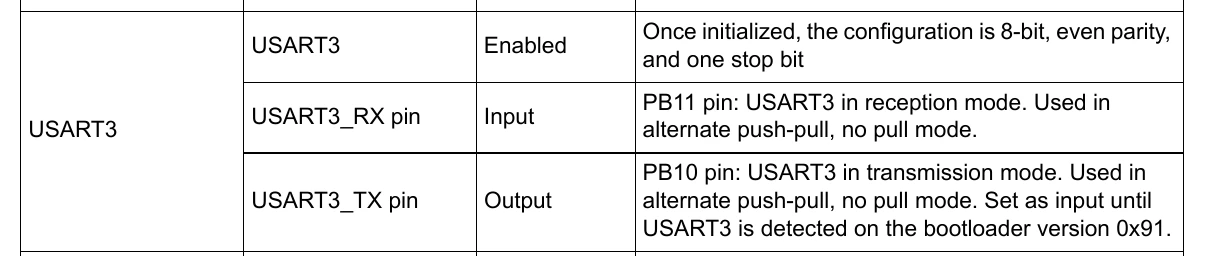

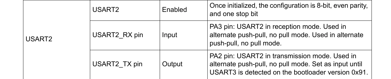

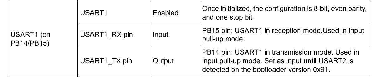

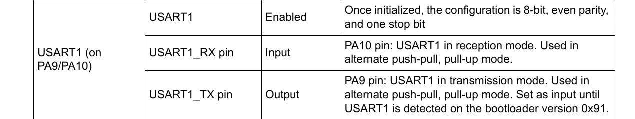

Try with correct pins , see AN2606 :
or
4 replies
Aug 6, 2026 1:27 PM UTC
PA9/PB15 is not a supported UART bootloader pin combination per AN2606. Does this really work on a nucleo?
Oher peripherals need to be quiet when the bootloader starts. Are you using USB? Schematic would help. See AN2606 for other peripherals that need to be quiet and the bootloader entry process in general.

It is working actually where we used USART3 (PB11,PB10) instead of USART1. Thank you for the support
