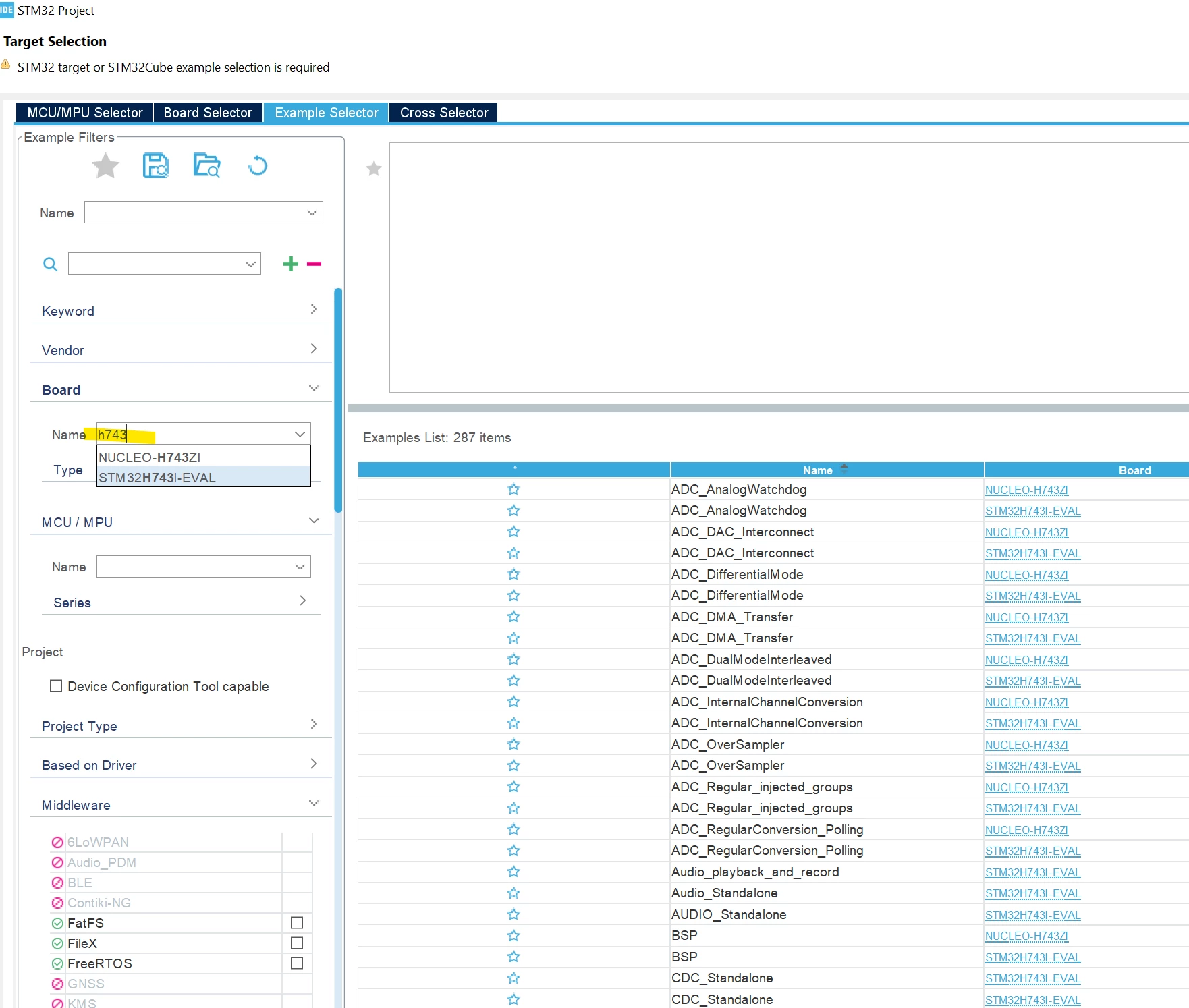

I have a NUCLEO-H753ZI board that I want to work on, I previously have some experience with stm nucleo boards. I was looking for a youtube playlist or project walkthroughs tutorials to get familiarized with this board although I wasn't able to find any. Do you have any resources which I can follow in order to get familiarized with H7 series. Any resource will help. Thank You

I've always found manuals to be quite instructive, but I'm relatively old, and from the pre-internet
ST had Reference Manuals and Programming Manuals. And Manuals covering the boards. Schematics can be found under the "CAD Resources" tab of the product pages.

There are many examples you can look at. Just use the example selector in STM32CubeIDE and select the H743 as it is the same as the H753
