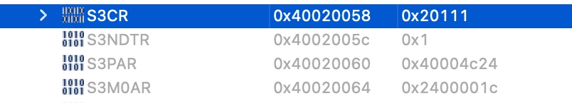

Hi everyone, just a question about this DMA not triggering for unknown reasons.
The only thing I can deduced is the switch from C to C++ and how variables behave within an object maybe.
All I know is the peripheral is working and the DMA is setting the right flag. I also tried the C version of my code and it worked. Double check the buffer is in the right memory region as well the RAM_D1.
0693W00000BcUZfQAN.png0693W00000BcUZpQAN.png0693W00000BcUZuQAN.pngFor some reason it doesnt wanna hit the void DMA1_Stream3_IRQHandler(). Yes I used the

TDKBest answer
Jun 30, 2021 8:35 PM UTC
The linker is looking for "DMA1_Stream3_IRQHandler", but if this function is with in a C++ file, the name it is mangled and so the linker doesn't find it. (It still compiles because there is a weakly defined default handler that it falls back to.)
Enclose the function in extern "C" brackets.

YUP! Just found this solution as well and that exact reasoning as to why using it. Thank you
