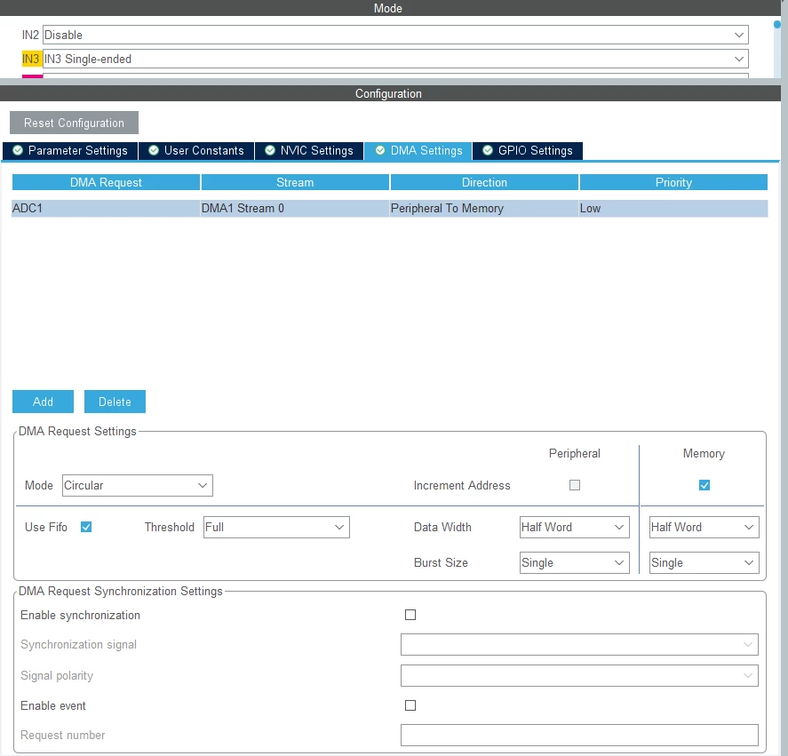

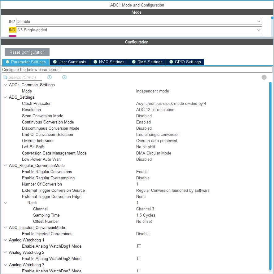

I am using NUCLEO-H753ZI (STM32H753ZITxLQFP144).
Using ADC1_IN3 Single-ended (PA6) and DMA (Mode:Circular),
I want to perform high-speed sampling. (1MSa/s or more)

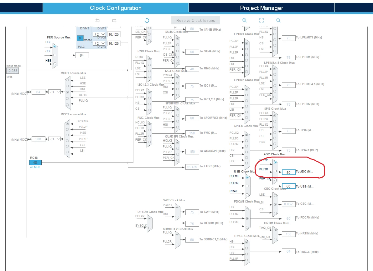

Calculated: 3.125MSa/s = 50MHz / 4 * (1.5 + 6.5) (Supplement: clockPrescaler=4, 1.5Cycles, 6.5ADC clock cycles)
*The clock uses 50MHz of PLL2.
However, it seems that the speed is only around 500kSa/s.
Please advise if there are any possible causes or places where the settings may be incorrect.

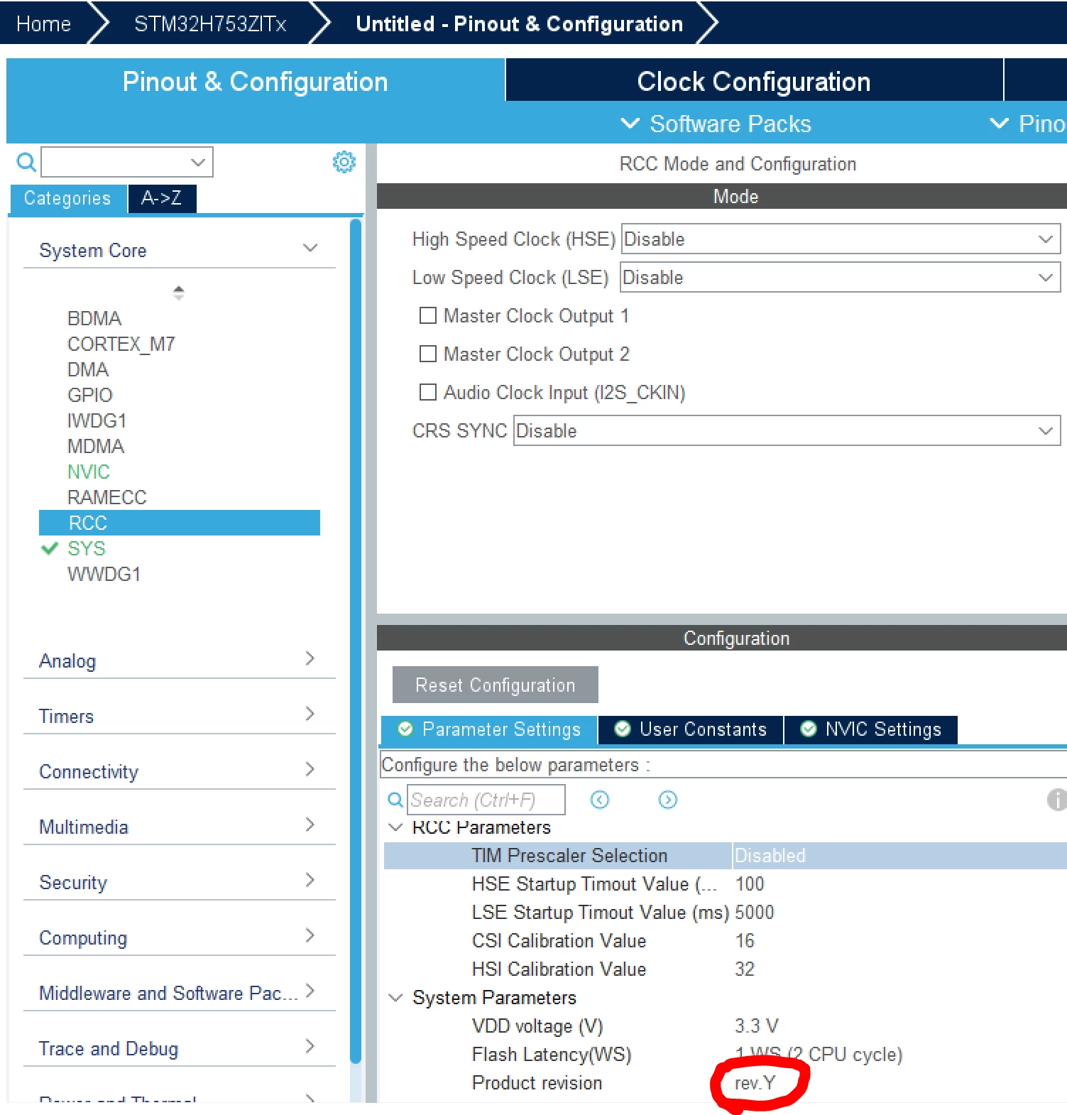

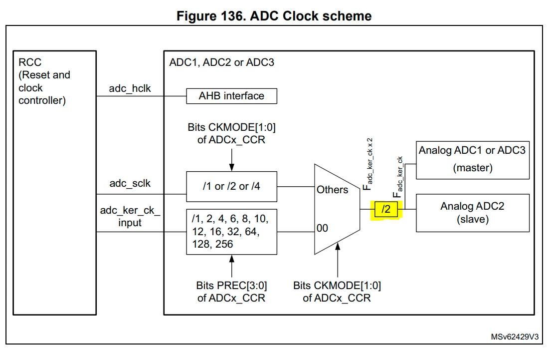

Take a look at the reference manual at the 25.4.3 ADC clocks section to see how the ADC clock is derived. This is the clock figure for the V revision. The Y revision does not have this divisor.

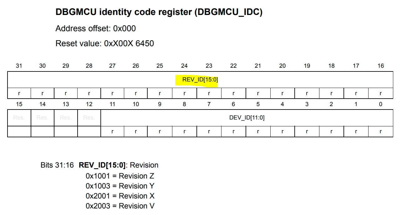

To find out what hardware revision you have, you can read the REV_ID field from the device.
You can read this field with the HAL_GetREVID() function and adjust your ADC prescaler accordingly.
if (HAL_GetREVID() == REV_ID_V) {
 // prescaler 2
} else {
 // prescaler 4
CubeMX also has a setting you're supposed to set based on the revision. Not sure how this plays into code generation.

The settings are done according to the attached contents.
The sampling time is confirmed as follows.
1. Prepare a 100 point buffer
2. Hit GPIO
3.Start ADC
CubeIDE_1.pngCubeIDE_2.pngCubeIDE_3.png→ HAL_ADC_Start_DMA(&hadc1, &adc1_data, SIZE)
4.Callback function that occurs when ADC completes
→ void HAL_ADC_ConvCpltCallback(ADC_HandleTypeDef* hadc)
*Hit GPIO here
*Estimate the sampling time from the time between GPIOs using an oscilloscope.
I don't think this math checks out. 50e6/4/8 = 1.5625 Msps
Note that revision V devices have an additional /2 ADC clock scaling.
