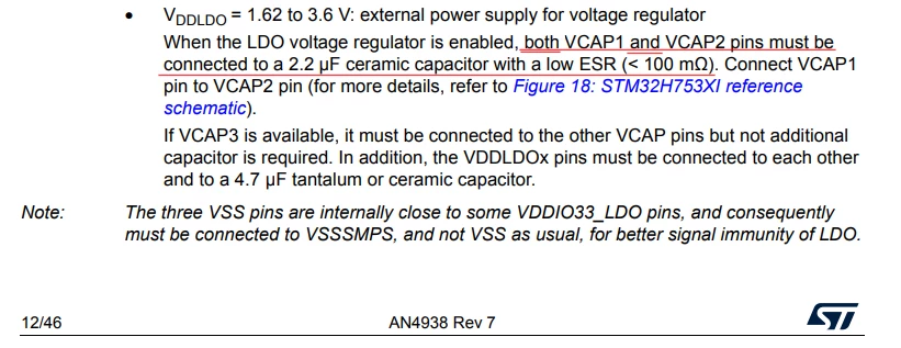

I am trying to figure out these VCAP conections.
From the datasheet I could look like they are internally connected together, for this reason could avoid routing these three pads together on my board.
Can anybody confirm that is the case?
Thank you.

No. You should connect them externally. If they are two or three pads on a package there is a reason behind.
Not connecting them externally leads to an unexpected behavior.
This is how you should connect them:
Please refer to AN4938 "Getting started with STM32H74xI/G and STM32H75xI/G MCU hardware dev" / Figure 18. STM32H753XI reference schematic.

Great thank you for a fast and precise answer.
