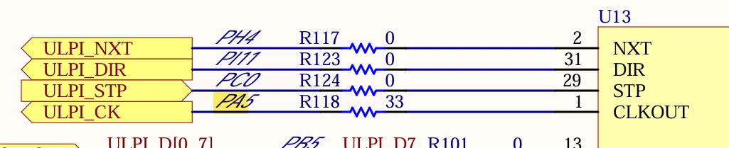

I am new to STM32 and I have to do a data acquisition board project using the STM32H7 MCU.
I have the STM32H753XI-EVAL evaluation kit and I am trying out all the features one by one.
I'm currently working on the DAC, which I have configured on CHANNEL2 on PA5. I am trying to start it up, send it a value, and then get its value to check and measure it using a voltmeter on PA5 of CN6 on the evaluation board.

Results :
UART : DAC Set Value: 3000 | DAC Get Value: 3000
Volt : 2.3V No matter what value I set.

According to the schematic, pin PA5 is in use on that board for the ULCP_CK function. It is being driving by U13. You can disconnect it from this by removing R118.

Ok that worked, i removed the R118 and it worked well.
Thank you very much !!!
