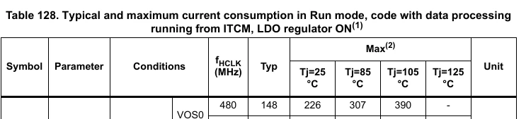

53° seems ok, at 480M .   See ds for current :
200mA at 3v3 giving about 0.7W heat...assuming about 50°/W , for lqfp100 case on pcb,  you get +33°, so at 24° ambient : 57° to expect, at max current.
btw
Thats why i run my H743 at 200M , VOS2, giving about 60mA heat;  in lqfp144 case, about +5° rise above ambient.
