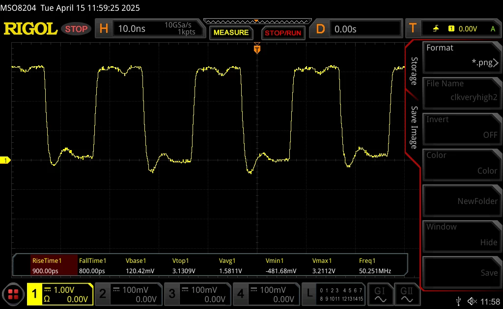

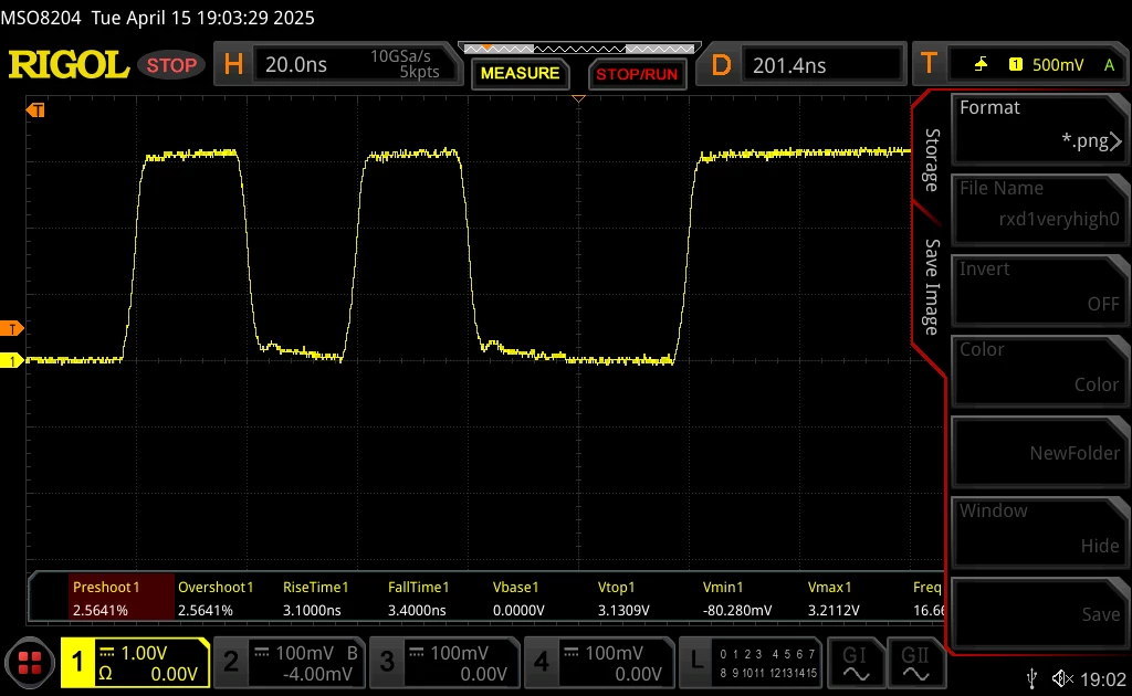

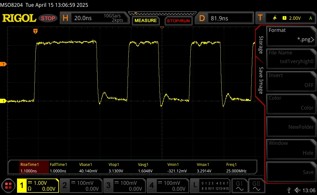

Hi Team,
We are using the STM32H753VIH6 in our design.
We are connecting the Realtek RTL8364 through RMII interface.
I have powered the STM with 3V3.
Attached the waveforms for undershoot and overshoot accepted levels.
This has been probed with 2GHz Oscilloscope of 8GSa/s.
Kindly provide your comments.
Thanks
Manikandan R

April 21, 2025
Hi ST community,
We have interfaced STM32H753VIH6 with RTL8364 through RMII interface and validated it.
We have captured and attached the signals of CLK, TXD and RXD using oscilloscope with probe capacitance less than 1pF.
In the captured waveforms, we have observed undershoot on those signals. Whether the undershoot levels are below threshold? Kindly provide your inputs.
Thanks,
Karthic V
