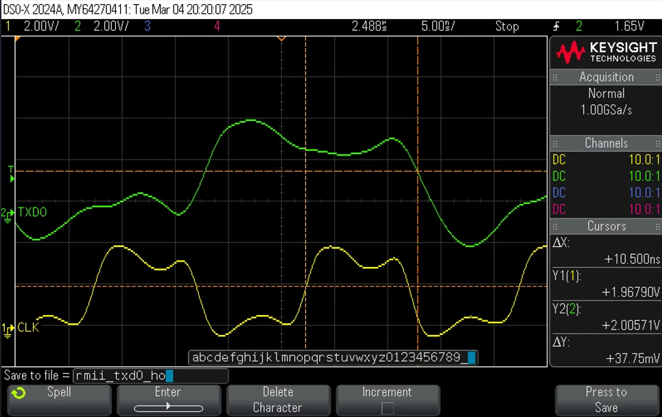

Hi Team,
We are using the STM32H753VIH6 in our design.

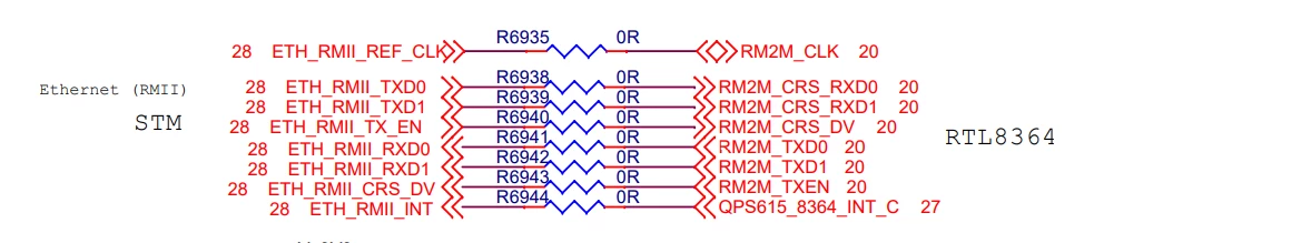

We are connecting the Realtek RTL8364 through RMII interface.
Connections are in the attachment and we have validated link between the two.

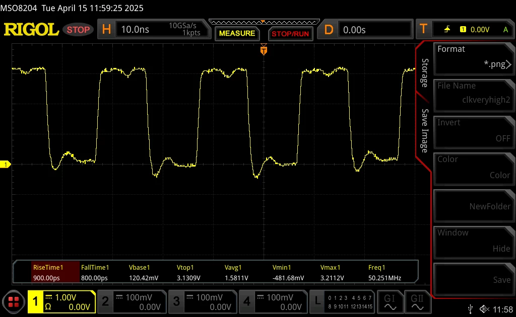

I have captured the waveforms , but the voltage span looks incorrect(going beyond 3.3V)  because the STM is powered by 3.3V.
Need inputs to capture proper waveforms.
Thanks

Dear @Manikandan ,
Looking to the waveforms, there is a serious issue with signal integrity !  can you please share your schematics and lines RMII Terminations ? including the Clock of 50MHz and how is generated.  So, Our valuable community members  can help further.
Ciao
STOne-32.

The STM32 and Realtek RTL8364 are connected with 0E resistor in series.

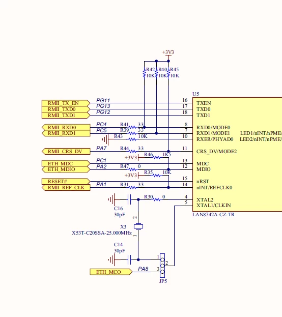

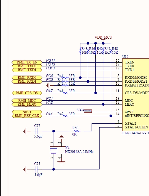

I think better to inspire from one of the ref designs of ST boards:
From Nucleo-H743 schematics:
From STM32H743-Eval schematics:

March 19, 2025
Dear ST community,
Is the external PU is mandatory?
As per this reference let me introduce 33E in the series path of CLK, RXD0,RXd1,CRS_DV and will capture the waveforms.
Any inputs on the Voltage span ?
Thanks
Manikandan R

Hi Team,
Sorry for the delayed response.

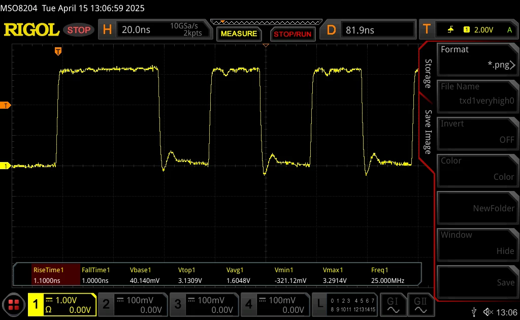

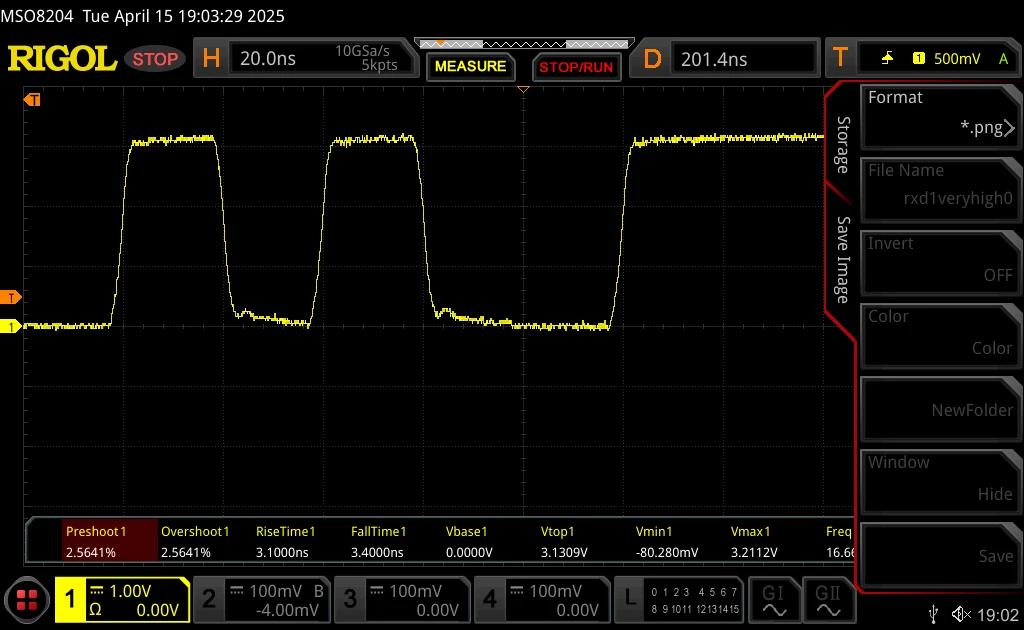

The previous attached images are captured with 200Mhz of 2GSa/s Oscilloscope with probe capacitance of 11pF
The attached images currently captured with the 2GHz of 8GSa/s Oscilloscope with probe capacitance of 1pF.
Would like to know the undershoot levels are accepted or not.
