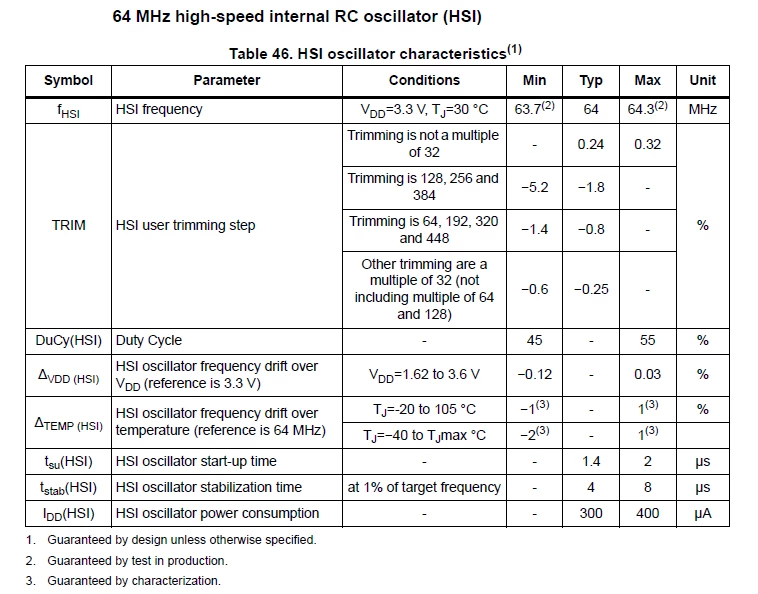

STM32h753bit6 HSI clock at startup
tying to find what frequency the hsi is at startup  and normally i search the datasheet for clocks and startup but this returns nothing in the datasheet for the stm32h753bi mcu only thing i see is that it has 4 clocks and it says the hsi is 64mhz is this it

Hello @Franksterb92
the HSI Clock frequency is indicated, as you said, on the DS12117:
Best Regards.

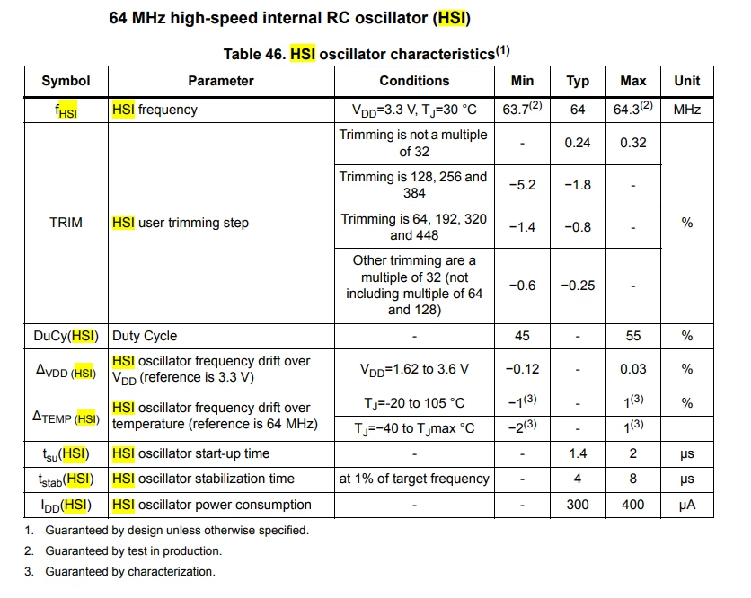

Aug 19, 2024 8:03 AM UTC
You're right , it's 64Mhz.
