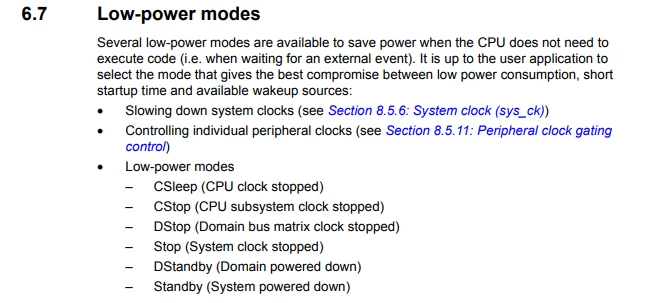

What are the different power saving mode for STM32H753 with there current consumption. What are the active functions in each mode?

The information is available in the RM0433 / 6.7 Low-power modes
The power consumption is provided in the product datasheet/ section 7.3.6 Supply current characteristics starting from the table 128.
See also this presentation.

see ds for power consumtion, also at different modes.
https://www.st.com/resource/en/datasheet/stm32h753vi.pdf
